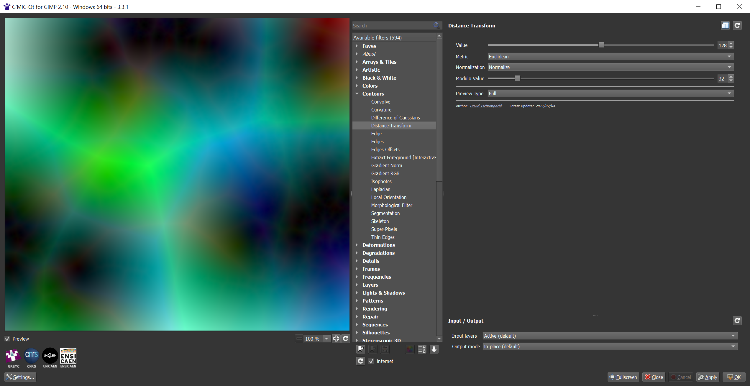

On the top layer run Distance transform per below:

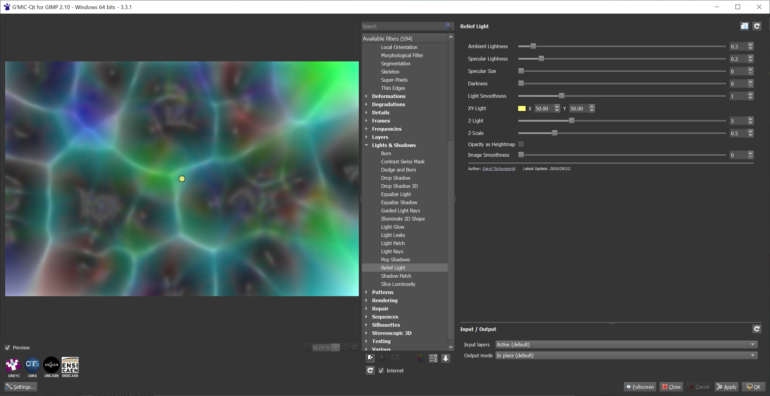

Now dup that layer and run Relief light (set opacity to 50%) and merge two layers (settings for relief light):

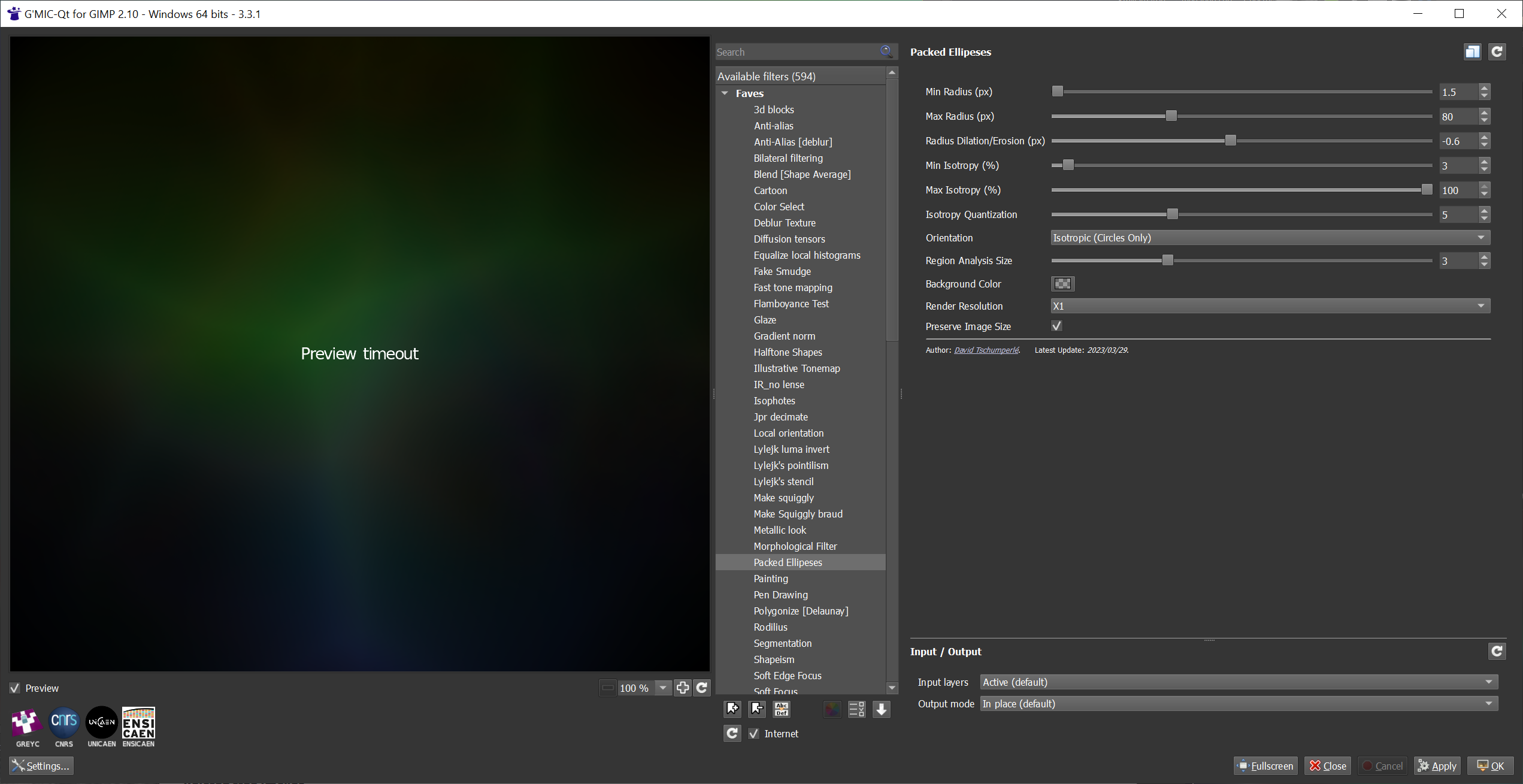

Now run Circlism on this layer (note, preview times out and indeed this one took over 2 minutes on my PC; lol):

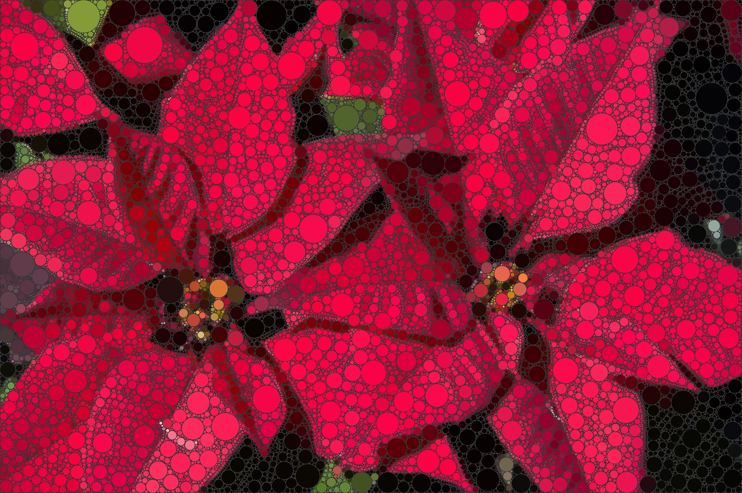

Won't leave you folk in suspense any longer; below's the result. lol

Whoops; I was doing so many circlism renders that I forgot I was using the favorite I created for the preset. Below's the actual path for this preset (with settings used in tut; note those settings are not the defaults for this preset). :)
