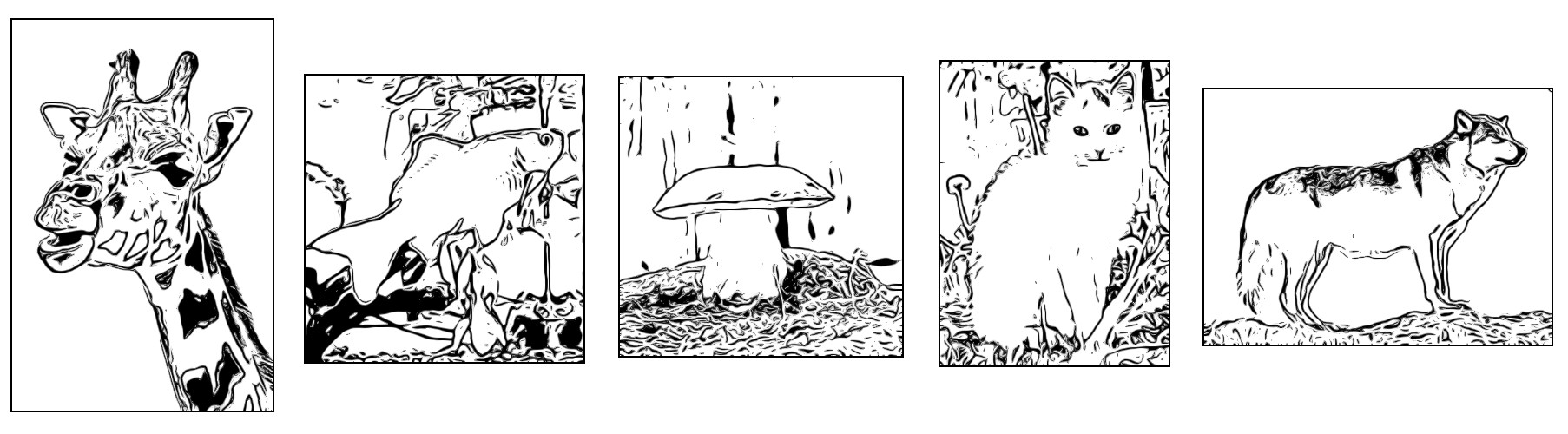

Hello! :)
I intend to propose a new dedicated G'Mic filter "Line Art".
With default parameters, it would give these results:

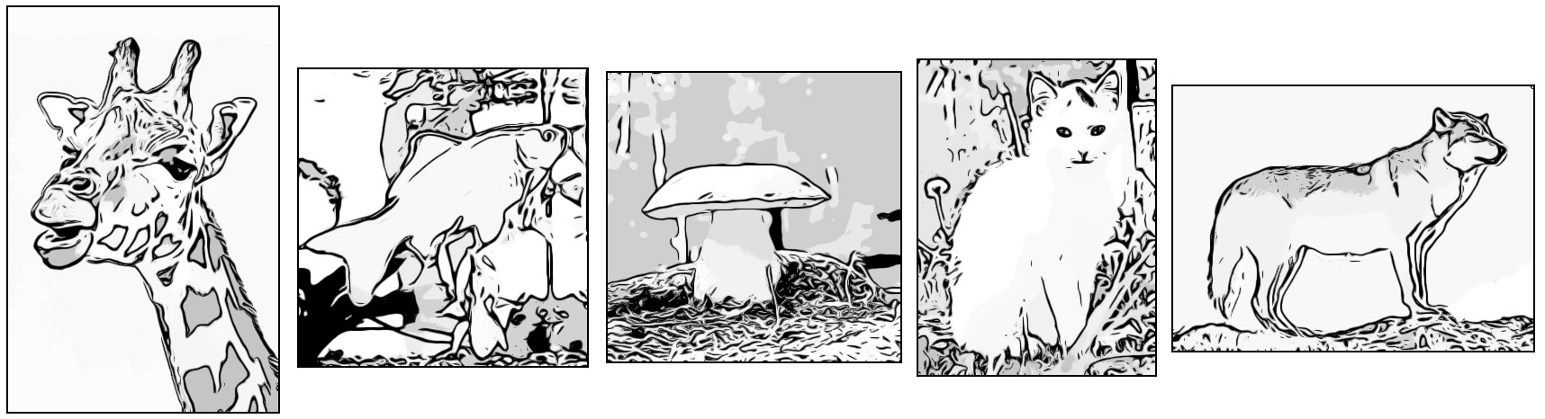

With "type=Gray Patches", it would give:
Here is its code:
#@gui ____<b>Artistic</b>
#@gui Line Art (prerelease): cl_lineart_prerelease, cl_lineart_prerelease_preview(0)
#@gui : note = note("<b>Photo to Line Art</b>")
#@gui : sep = separator()
#@gui : note = note(" ")
#@gui : Local Contrast Enhancement = int(0,0,4)
#@gui : note = note("<b>For edges:</b>")
#@gui : Flattening for Edge (bilateral) = int(2,0,5)
#@gui : Line Thickness = float(1,0.5,2)
#@gui : Line Strength = float(15,0,19)
#@gui : Add Black or Gray = bool(1)
#@gui : note = note("<b>For black and grays:</b>")
#@gui : Luminosity Increase = int(0,0,40)
#@gui : Final Flattening (bilateral) = int(6,0,10)
#@gui : Lines Antialias = int(15,0,100)
#@gui : Type = choice(2, "Soft Threshold", "Gray Patches", "Lines and Black", "Black and Lines")
#@gui : Final Antialias = choice(2, "None", "Light Simple", "Simple", "Very Strong")
#@gui : Preview Type = choice("Full","Forward Horizontal","Forward Vertical","Backward Horizontal",
#@gui : "Backward Vertical","Duplicate Top","Duplicate Left","Duplicate Bottom","Duplicate Right",
#@gui : "Duplicate Horizontal","Duplicate Vertical","Checkered","Checkered Inverse")
#@gui : Preview Split = point(50,50,0,0,200,200,200,0,10)_0
#@gui : url = link("Filter discussed here","http://gimpchat.com/viewtopic.php?f=15&t=5328&start=10#p270912")
#@gui : note = note("<small>Author: <i>Claude Lion</i>.      Latest Update: <i>2022/04/03</i>.</small>")
#@gui : note = note("<small>It uses filters of David Tschumperlé and a few filters of Jérôme Boulanger.</small>")
#@gui : note = note("<small>Type='Lines and Black' is a shortcut of 'Black and Lines' with 'Local Contrast Enhancement = 1' and 'Luminosity Increase = 40'. In this case, 'Local Contrast Enhancement' and 'Luminosity Increase' cursors have no effect.</small>")
cl_lineart_prerelease:
   locContEnh=$1
   nbBilatBord=$2
   lineThick=$3
   forceTrait=$4
   addGrays=$5
   augmLum=$6
   nbBilatFin=$7
   antialias=$8
   type=$9
   finalAntialias=$10
   repeat $! l[$>]
      if $type==2
         locContEnh=1
         augmLum=40
      fi
      fx_LCE. 80,{$locContEnh/2},1,1,0,0
      curv="0,0,"{50-$augmLum}","{50+$augmLum}",100,100,-1,0,0,30,70,100,100,-1,0,0,100,100,-1,0,0,100,100,-1"
      +fx_curves_interactive.  7,0,1,"7",$curv
      fx_smooth_nlmeans.. 4,4,10,5,0,0,24,0
      fx_smooth_bilateral.. 10,7,$nbBilatBord,0,0
      +cut.. 0,255
      reverse[-2,-1]
      blur[-3] {$lineThick}
      sub[-3,-2]
      fill.. "M = max(R,G,B); [M, M, M]"
      cut.. 0,255 n.. 0,255
      negate..
      threshold.. {$forceTrait+80}%
      n.. 0,255
      fx_smooth_antialias.. $antialias,0,1,0,50,50
      if $addGrays==1
         mul[-2,-1]
         n. 0,255
         fx_smooth_bilateral. 10,7,$nbBilatFin,0,0
         if $type==0
            fx_curves_interactive. 7,0,1,"7","0,0,60,0,80,100,100,100,-1,0,0,100,0,-1,0,0,100,100,-1,0,0,100,100,-1"
         elif $type==1
            if s==2 split_opacity. rm. fi
            +colormap. 8
            index.. [-1],0,1
            rm.
            rgb2hsl. split. c
            n. 0,1
            append c hsl2rgb
            fx_blackandwhite. 0.299,0,0.587,0,0.114,0,0,0,0,0,0,0,0,0,2,0,0,0,16,4,0,0,0,50,50
            fx_curves_interactive. 7,0,1,"7","0,0,20,80,100,100,-1,0,0,100,100,-1,0,0,100,100,-1,0,0,100,100,-1"
         elif $type>=2
            otsu 4
            n 0,255
         fi
      else
         remove[-1]
      fi
      if $finalAntialias==1
         fx_smooth_antialias. 15,0,1,0,50,50
      elif $finalAntialias==2
         fx_smooth_antialias. 50,50,2.5,0,50,50
         #gcd_despeckle 50,1
         #fx_smooth_antialias. 15,20,1,0,50,50
         #fx_smooth_antialias 100,50,1,0,50,50
         #fx_smooth_antialias 100,50,5,0,50,50
         #gcd_despeckle 50,1
      elif $finalAntialias==3
         fx_smooth_antialias. 100,0.5,5,0,50,50
      fi
   endl done
cl_lineart_prerelease_preview:
   gui_split_preview "cl_lineart_prerelease $*",${-3--1}
Installation:
  • Copy and paste the above code into the file "~/.gmic" on Linux or the file "%APPDATA%\user.gmic" on Windows.
  • The new filter appears in "Filters -> G'MIC -> Artistic -> Line Art (prerelease)".
Have fun! :)

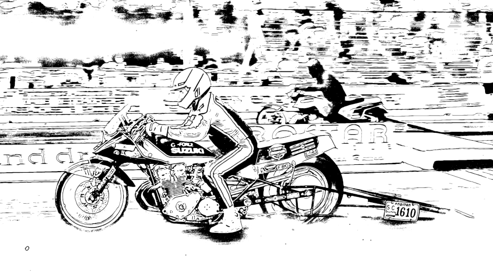

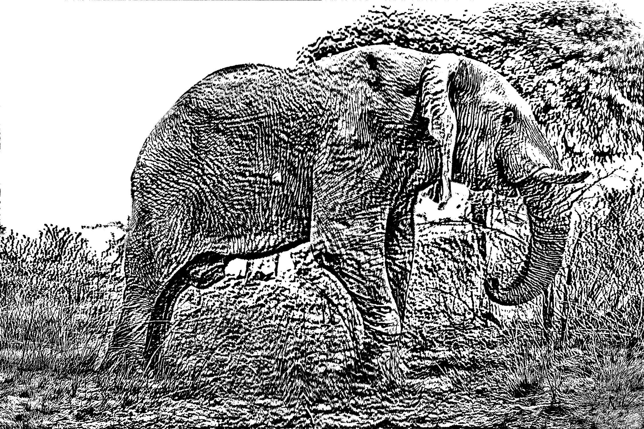

Sorry for the belated reply; meant to do so a week ago but got busy. lol
Anyway, one of my favorite ways to create line art is G'MIC's Engrave preset. Of course I added some secret pre and post processing to the mix (it's what I do). :)
