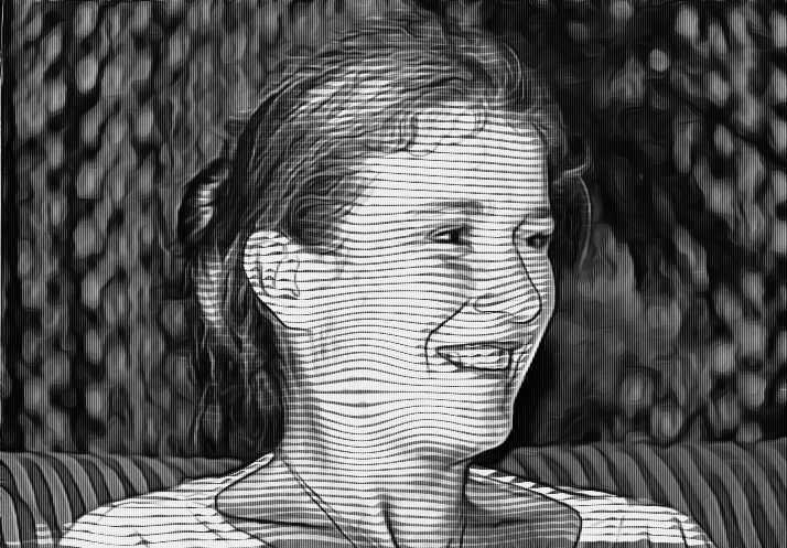

I recently working on the about page for pixls.us when I thought it might be fun to gussy up the portraits. This led me down the rabbit hole of wanting to emulate the hedcut effect that Randy Glass uses for the Wall Street Journal portraits you'll see above the fold.
So I experimented a bit, and finally ended up at something that was not exactly like those, but I thought was interesting enough to share.
So, here's a sample of someone you might know, from a portrait I shot of him at LGM this past year:
And here's an older headshot of my friend Mairi in the same style:
The steps are all on my post here:
patdavid.net: Woodcut/Hedcut(ish) Effect
The steps are basically:
Desaturate the image, and create a duplicate of the layer.
Run G'MIC/Graphic Novel filter, skip local normalization. Set layer opacity to about 40-60% (experiment).
Create new layer from visible.
Run Filters → Artistic → Engrave (not Filters → Distorts → Engrave!).
Set the Line Height ~ 1/100 of image height, black on bottom
On the same engrave layer, run G'MIC → Deformation → Random
Set amplitude to taste
Change layer mode to “Darken only”
Add a layer mask, use the original desaturated layer for the mask
Add a layer mask, using the original desaturated layer for mask again (or the mask from previous layer)
Adjust levels of layer to brighten it up a bit
Create (another) new layer from visible
Set background color to white
Run Filters → Distorts → Erase Every Other Row...
Set to columns, and fill with BG color
Set layer blend mode to “Overlay”
Then fiddle with it until it looks good. :)

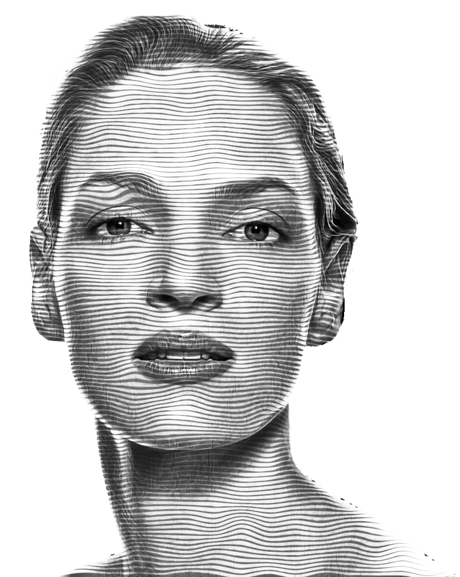

Very nice tute Patdavid here is my finished effort
but wait I have another subject to work on
Sorry Lyle but you know I just had to

This is something that deserve its own name/term. It's quite distinct and I've not seen anything like this!
Especially love your male portrait and Graechan's Uma Turman portrait.

Another result from playing around (from the GIMP team):
