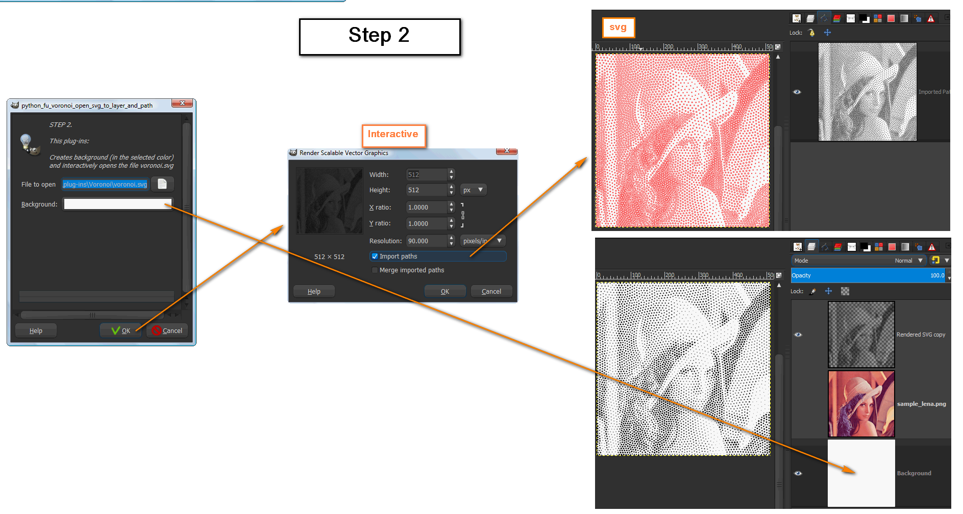

PostPosted: Sat Dec 15, 2018 2:02 pm  (#10)
Posts: 2240
Small update for Gimp 2.10 and some changes in the plugin interface.
Note: for correct operation, edit (preferably in notepad ++) lines 33,37,44,46,62,96 in the Artistic VoronoiSwitch.py file and line 5 in the vorbw.bat and vorc.bat files to determine the correct path to the directory Voronoi.

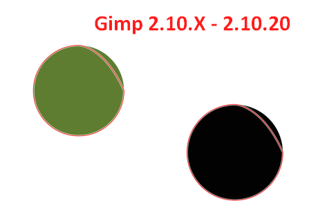

PostPosted: Tue Oct 13, 2020 2:29 am  (#14)
Posts: 2240
This bug was only fixed in Gimp-2.10.22 :hehe

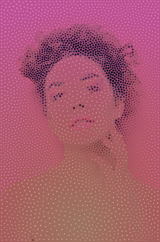

Posts: 1389
Location: FInland
Thanks MareroQ, this is great. :bigthup
I'm using the voronoi stippler from terminal on Linux, or The Evil Mad Scientist Laboratories StippleGen2.

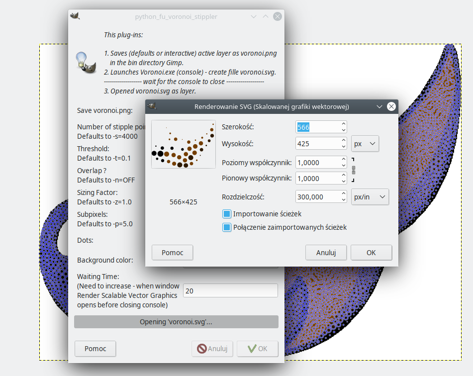

Posts: 2240
Thank You Nidhogg. :hi5
I've updated (compiled) Gimp to version 2.10.22.
I completed the voronoi stippler.py code to the location (user / bin / voronoi_stippler) - and it works in Ubuntu 20.04.
This can be a bit of a hassle - but the console window isn't visible.
