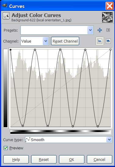

For plain fabric, you can apply different textures like we’ll be doing in a minute, but for Satin we need our fabric to be really shiny. Click on the Satin layer to make it the active layer, then go to Colors>Curves and use the “Max chrome” settings from my Tin Foil tutorial to adjust the curves. You can find the Tin Foil tutorial here:
viewtopic.php?f=23&t=3466
If you don’t already have those chrome settings saved, after you make your changes like in the Curves dialogue below, just tick the little plus sign at the top. When the little box comes up, it will ask you to enter a name for your settings, and then click OK.
Make your Curve settings look like the picture shown here.
After applying the Curve settings, you will notice there are a lot of weird little “artifacts” or swirly lines.
To fix this, go to Filters>Blur>Gaussian Blur and use 25 for both settings.

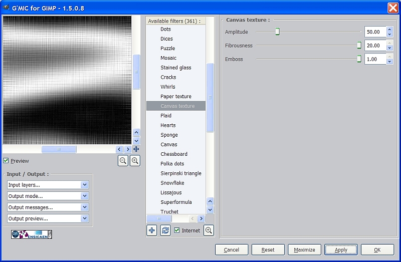

Tick the eye in front of your blue layer to make it visible, click on the Linen layer to make it the active layer and tick the eye in front of it to also make it visible. (I’ll be using the blue layer with the mode set to overlay for the next few steps) Go to Filters>GMIC> Patterns>Canvas Texture and enter the values shown in the screenshot below.
Now we have some Linen fabric.
If you want more texture, just crank up the Amplitude setting a bit but not too much.
