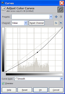

Go to Colors>Curves and adjust the middle of the curve down about a half a square to make the 3D layer (allen screw copy #1) a little darker and the 3D portion shows up more.
Let’s go ahead and turn off the guides while we are at it, so our image should now look like this.

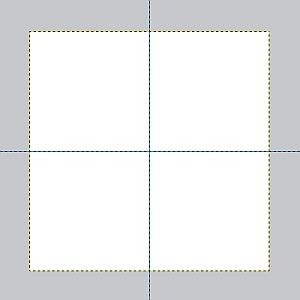

Let’s go back to our gray circle layer again only this time, name it Slotted Screw. Create a new transparent layer above it named Slot. Set the FG color to 5A5A5A and Alpha Select the Slotted screw layer. On the slot layer, use the paintbrush tool and the largest circle brush set to .36 to make a diagonal line across our selection like so.
Step 2.
Remove the guides and turn off the selection. Alpha to Selection on the Slot layer and select the slotted screw layer to make it active and hit the delete key, then Select>None. Set your view to about 800% so you can wok carefully. Reselect the Slot layer and use the Eraser tool with the square brush included with this tutorial, to cut out just a little of the top of the slot in our image.
Working carefully, and utilizing the square brush with various sizes, and sometimes one pixel at a time if necessary, keep removing more to shape the slot until your image looks like this.
