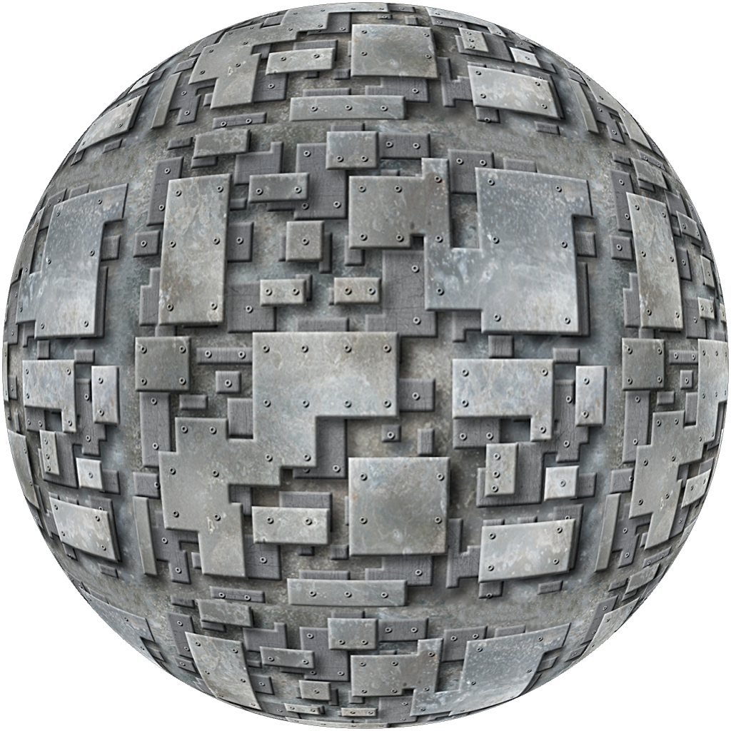

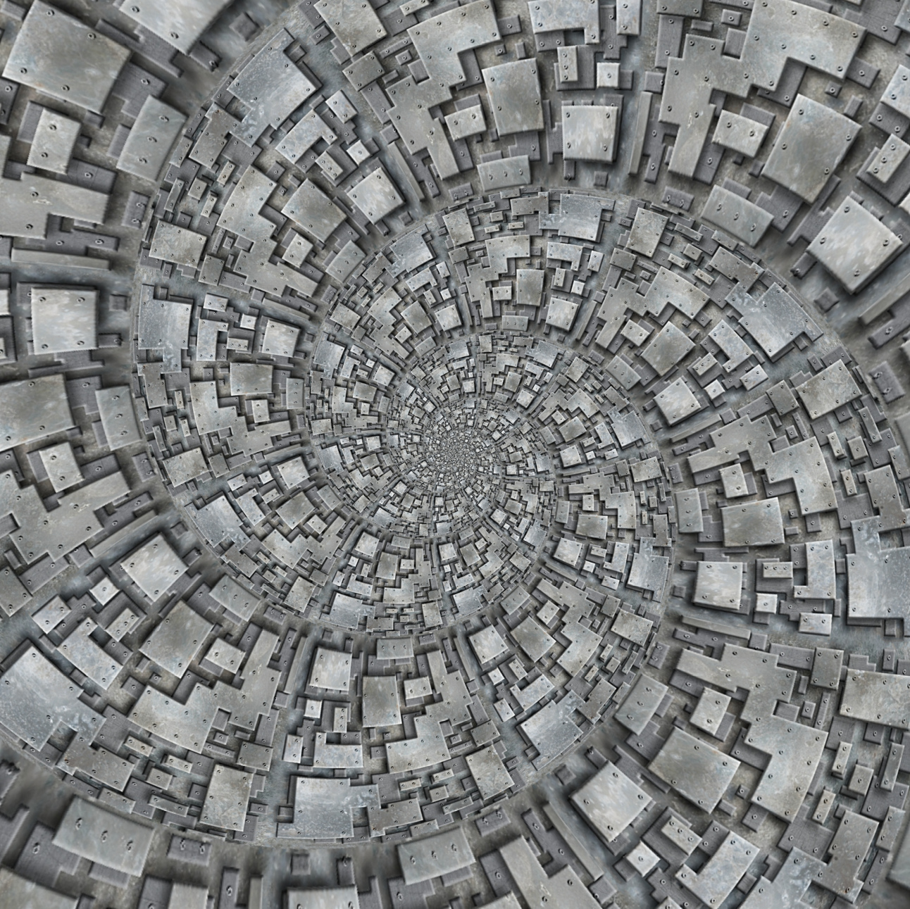

Some play with the texture created. :)

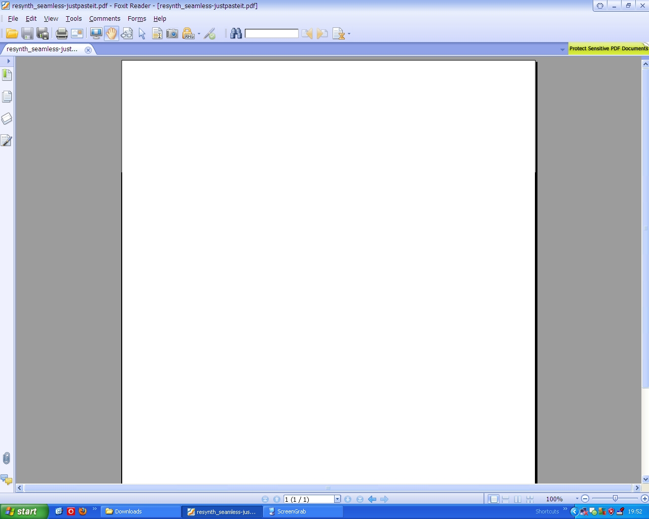

Hey. I like the save as PDF function on that site. Makes life a lot easier.
OK, so I lied.

I screengrabbed it in the end. Thanks.

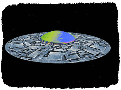

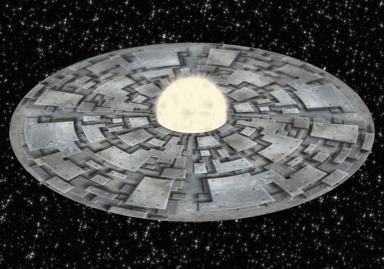

I like the UFO result too by the way; guess I should share the top view (minus space background). Won't take any of Tux's storage space for this one though. Click for the hirez (png with transparent background). :)

 Post subject: Re: Using Resynthesizer to create seamless textures.
PostPosted: Wed May 09, 2012 8:31 pm  (#16)
Posts: 12519
Now that's too cool alc59. :)
