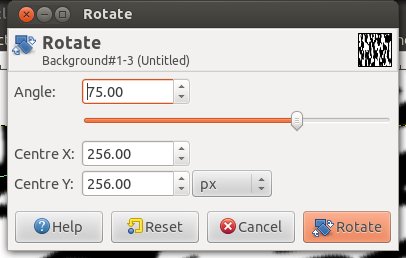

From the Toolbox select the Rotate Tool :rot and click anywhere on your main image, this should bring up the rotate tool window, change angle to 75 and click rotate.

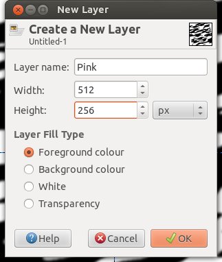

Change your foreground colour to ff69b4, then go Layer>New Layer and change settings to those shown in image and click OK.
Change foreground colour to adff2f, then go Layer>New Layer and change settings to those shown in image and click OK.
