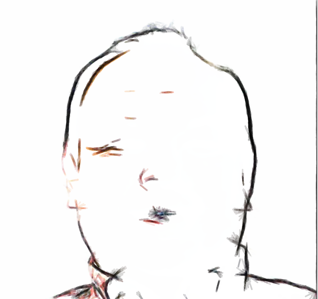

While you here, I noticed that the preview doesn't work for some of the presets such as solidy (and it inverts the color for felt pen preset preview but renders like it should). Not sure what's the issue. Solidy renders fine too by the way; it's only the preview. :)

Lyle, any file you could send us to reproduce the problem ?
Here, the preview looks good.

Strange; when I click the plus in the preview, it then renders the preview. Also when I change presets, I sometimes get a yellow ! icon and no render happens. Anyway, I've attached an image, but again, it just appears to be with the preview engine. Really see it if the image is at 100% and then you change between presets. :)

Not sure what the updates are, but noticed new versions of both qt and gtk released today for G'MIC. Looks like some of the preview issues have been addressed (at least I've not seen the inversion artifact in the preview yet with just the little testing I've done). :)
