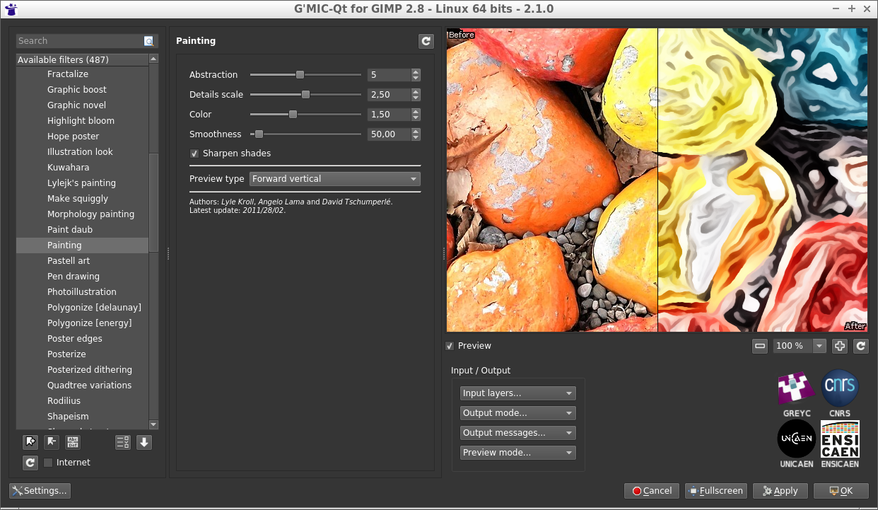

* Screenshot:

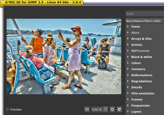

Okay, I'm making progress on my Xubuntu 17.04 system. I found out that I must install the gmic-gimp plugin in another place. Instead of the usual ~/config/GIMP/2.9/plug-ins it has to be placed in /usr/share/gimp/2.0/plug-ins/.
I found that out with your qt plugin rich, that I downloaded. Then I went to gmic.eu to get the latest stable release 2.1.0 and installed it in named /usr/share dir. That works as well, except that the title in the menubar says v2.0.4.
Am I right in thinking that the Reset button in each filter has gone? I often use that!
EDIT. I found it, it's the little Undo button on top of the filters!

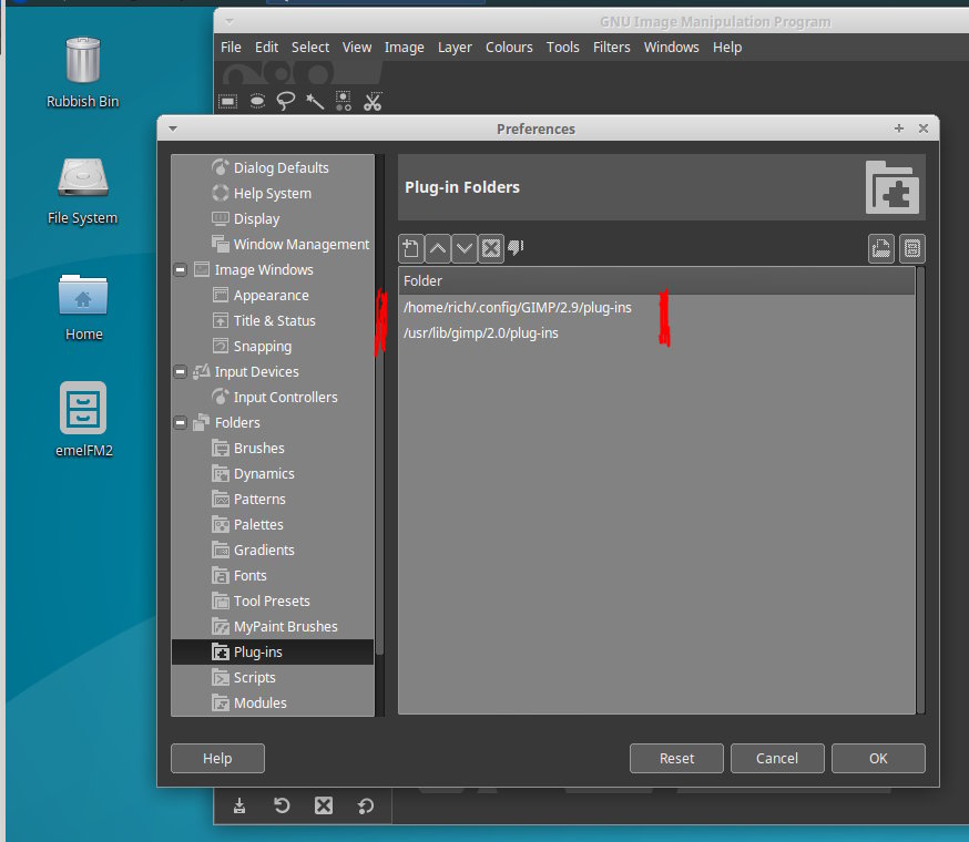

Delving into root and /usr/lib/gimp/2.0/plug-ins/ with possibly deleting something vital or
/.config/GIMP/2.9/plugins
What is /usr/share/gimp/2.0/plug-ins/ used for ????
Linux or Windows, Gimp 2.anything, the default locations are in Edit -> Preferences -> Folders
