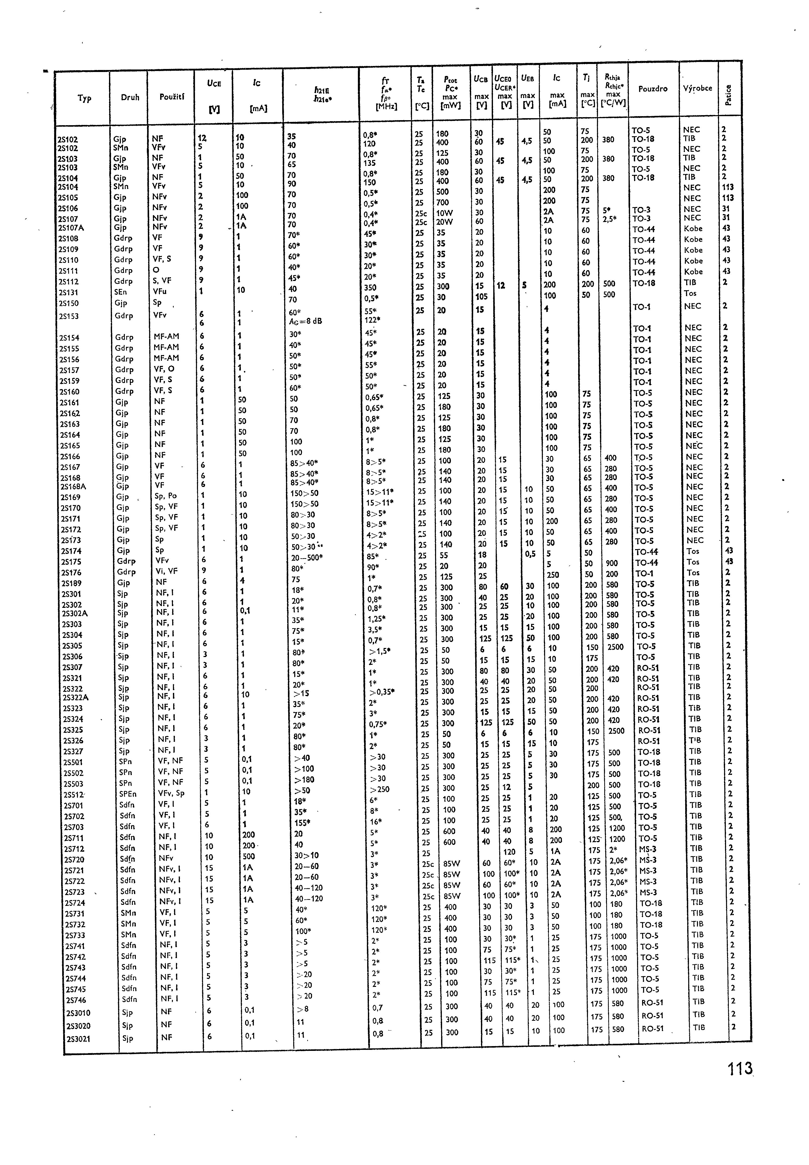

Thanks for the new plugin, it indeed works, but I'm having trouble with it. It runs very slow on full scanned pages, it takes several minutes to process one (I have AMD Threadripper CPU). And when the "Selection to path" bar finally fills, the plugin window hangs ("not responding" appears in the title). GIMP then constantly consumes full 8 CPUs, it happens with 2.10.34 and 2.10.38. When I force close the plugin window, an error message appears, I'm attaching a screenshot. However, it's possible to save the resulting image when I close it. I'm attaching one of the scanned pages, so you could debug it better.
BTW, ImageJ takes about 2 seconds to process one page with that script I posted earlier. After some trial-and-error, I set the unwanted spot size to "size=0-7".

I tried all 3 versions, but I liked the one with radius setting (from Sat Jul 13, 2024 9:22 am) the best. Although it deletes small parts of the > signs sometimes, it impacts them even less than ImageJ. Fantastic work! The default setting max=7, radius=3 seems to work best, I'm attaching comparison pic.
The other two preserve the > signs better, but also leave more unwanted dots in the image.
Edit: would it be possible for the script to preserve image mode? So RGB input => RGB output, grayscale input => grayscale output and 1-bit indexed input => 1-bit indexed output?

...... the filters fill the insides of number "4", which is highly undesirable. Is there some trick to remove only black spots?
A different approach to the problem of the '4's
find-and-replace-character-4.zip [1.04 KiB]
Downloaded 115 times
The script above tries to find and replace the '4' characters, the full scale sample image below shows one result. All the '4' characters have been replaced but alas with one unwanted error at 2nd column in, 12 up from the bottom
A value needs to be entered, the maximum allowed is 464 but no changes will occur, as the value entered gets lower more of the '4's will be replaced, at 403 the first error occurs and lower values give more errors
In the smaller image below
Left is a crop of the original full scale sample
2nd left, input value was 403
3rd left, input value was 397
4th left input value was 396
On the right the unwanted change can be seen when 403 was used
The downside to this script is that it took 95 minutes to run, If I can work out how Tims getting the super fast speeds that he is I will try and work it into the script, or hopefully Tim might beat me to it
If the script is run on the small png above you can see the result, it takes about 30 seconds
Full page sample character 4 - 85 minutes input 396.png [ 320.33 KiB | Viewed 4671 times ]
