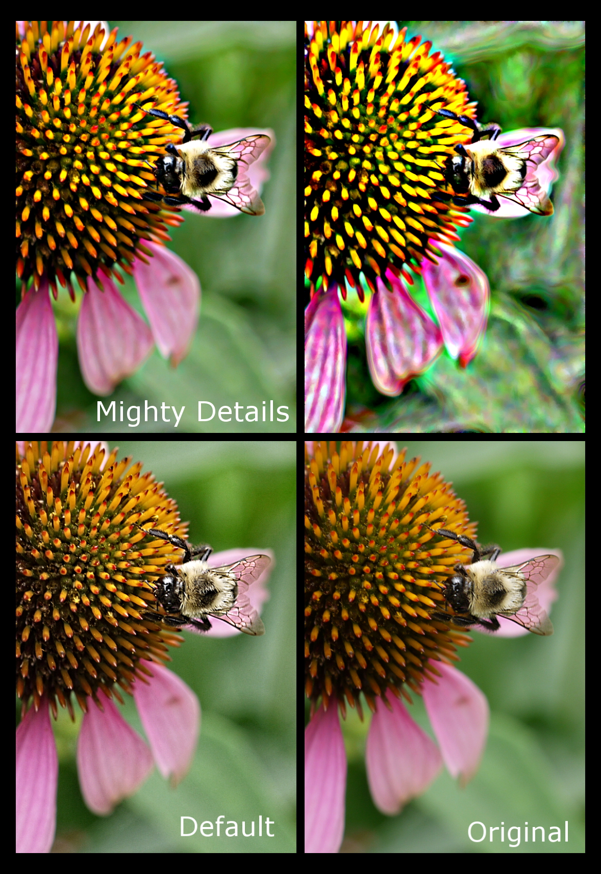

The default settings correspond to a classical Local Contrast Enhancement action :
Here is another set of parameters, to boost the image contrast more globally :
And another one to create painting effects :
And here is an example of what you can obtain, at full size :

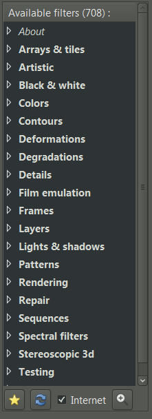

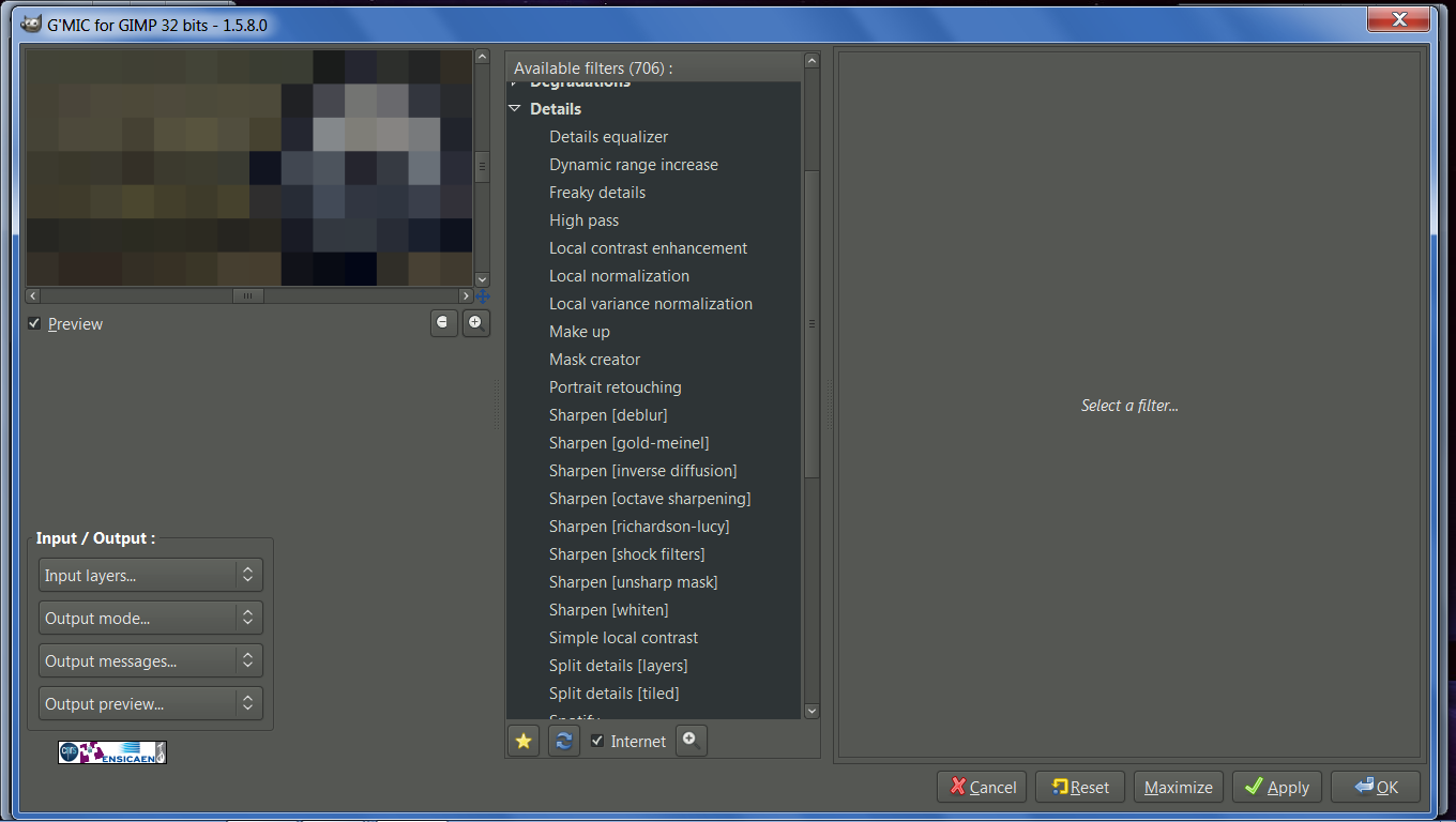

I've refreshed G'Mic, but this does not show up in the Details menu.
My G'Mic currently has over 700 filters; and from what I can see from the screenshots of the G'Mic plugin I've seen in this thread. There looks to be a little over 300 filters available that I can see.
Could something be wrong? Do I need to download a new G'Mic.exe?

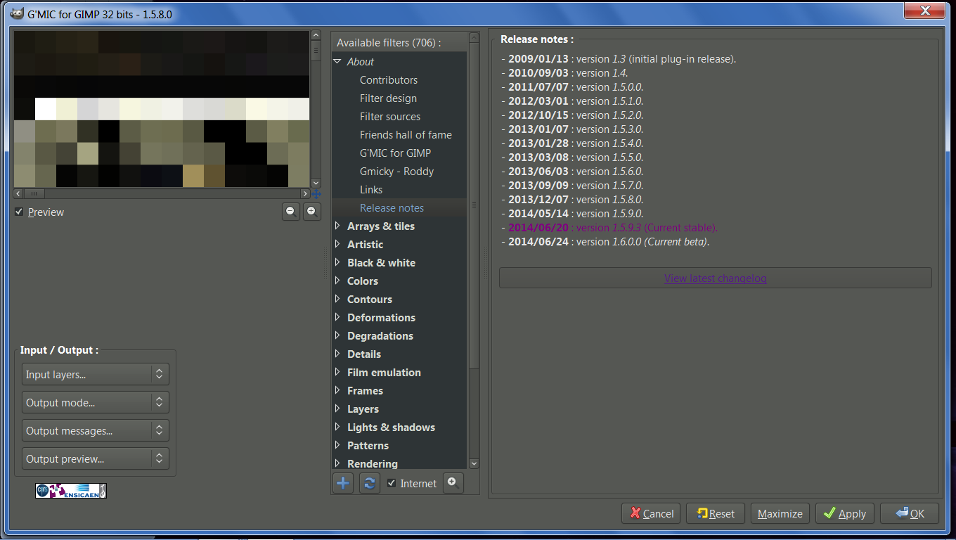

How do I know what version of G'Mic I have? Never mind, I opened G'Mic and it says I have 1.5.8.0.;
should I install a new G'Mic?

wow, are you sure you have that many? I have 392 available filters
You've seen my screenshot right? I have 706 filters for G'Mic.
Also I'm thinking that there's something preventing Gimp from connection to the internet. I disabled my internet security software, but still when I refresh G'Mic nothing changes.
Is there something I need to do to have Gimp/G'Mic connect to the internet to update stuff?
I would suggest upgrading. If your showing that many filters it probably means you're not able to refresh for some reason. He did mention 1.5.8.0+ and you have 1.5.8.0.
For more version info look under, About | Release notes.

This is what I see...
I click on View Latest Changelog and nothing happens. :help

Sorry to say, but I refreshed G'Mic once again with no results. Everything is still the same. It goes through the refresh, without any effect and no errors either. G'Mic Links are also not responding when clicked.
G'Mic shows 706 filter as before.

Wallace, mine went from 393 down to 392.
What filters did you remove Ronounours?

That's funny, mine went to 708. I gained 2 filters. :wh
List of current filter for G'MIC as of 8/10/2014... http://gmic.eu/gimp_filters.txt
