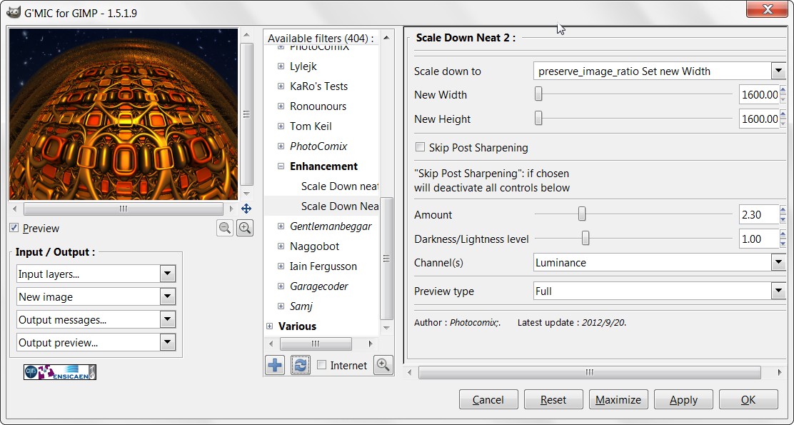

Please note that... i forgot the URL of my own source ( when i set it up I tried a lot of sides..now i can't remember which i chosen ) and so as now i cannot put there but only post here
The filter is for downscale ,it uses the method discussed here viewtopic.php?f=4&t=5303&start=20
and can NOT be used to scale up, the final width and height MUST be minor (or equal )the original.
marked in red the essential controls:
the pre-blur is computed automatically so all what is needed is chose the new image size :
there are 3 options:
1) Set new Width and Height, use this to scale differently W and H
2) Preserve image ratio, set new W
3) preserve image ratio set new H
All the others controls are for 1 optional step for post sharpening
For this i was tempted to simplify, removing most of controls and hardcoding most of values..please let me know what you prefer
below the simplified version

I tried a simplified version, to be simplified are only the controls for the optional post sharpening
I unified controls for Darkness and Lightness:
the Darkness/Lightness control now set the Darkness to the value chosen, the Lightness is 1/3 of the Darkness value
The 2 versions doesn't conflict let me know what you prefer

@ O, L (and everybody that may have already copied)
It was a typo in both, corrected now
i suggest to copy again

Then i just saved it to my home folder (rod).
I thought after I turned on my computer this morning it might work. Nada. I re-copied the code and saved it. Nada. :(
