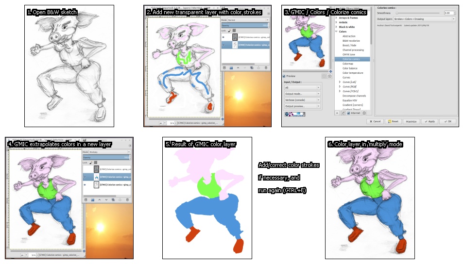

I've added another new filter in the G'MIC plug-in for GIMP (requires 1.5.6.0+), located in Colors / Colorize comics.
It is intended to ease the colorization of B&W sketch or comics, by trying to extrapolate user-defined color strokes the best it can, i.e. by following the geometry of the original B&W image.
I've done a self-explanatory image that describes the whole process :
The original sketch image has been taken from René van Belzen on Flickr (http://www.flickr.com/photos/aaipodpics/4897590498). The image is licensed under a CC-by-nc-sa creative commons license.
Note that when dealing with multiple layers for comics, a good idea is to consider them in the 'multiply' blending mode.

The difference is that 'Colorize comics' is focused on comics :)
'Recolorize' will spread only the chrominance informations from the color strokes you put on the top layers (so keeping the luminance of the photograph behind unchanged), while 'Colorize comics' will spread all the color informations on the image. It doesn't try to preserve the luminance information of the underlying sketch. That makes a huge difference.
Also, the priority map used to spread the colors is different. For 'Colorize comics' it is computed regarding the fact that you are using a sketch like image. It won't work with regular photographs.

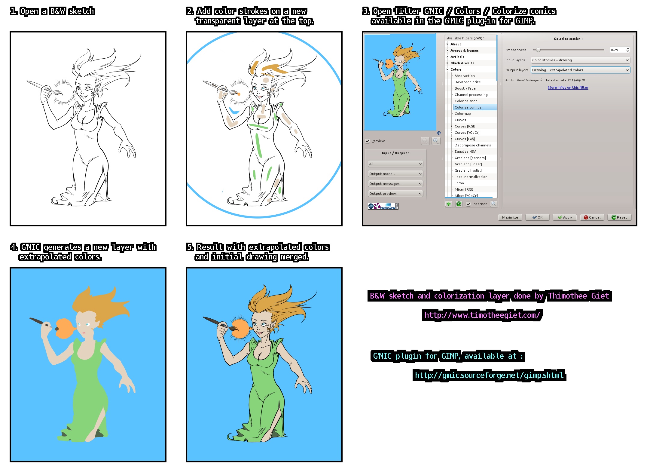

I had the chance of having a talented (French) illustrator, Timothée Giet (http://www.timotheegiet.com/) as a tester for this filter, and this is what he got. I must confess I'm very excited to see illustrators trying to do something with this filter for real work. he made my day :)

It does seem to have some small issues or Im not exactly groking it.
Test 1. Complicated Image - Full lineart exported as PNG out of Inkscape. In GIMP I added a white layer below the line art and then a transparent layer above the line art one which I placed my color strokes. Ran the GMIC filter with default settings. The result was definitely not what I was expecting. Colors strayed from the line art and looked more like an abstract piece than a comic. I dont think the filter likes open ends on lineart
Test 2. Simple image. Lineart exported once again as PNG from Inkscape. This time much simpler. Roundish head. Basic mouth, nose eyes and one ear. As this was an Inkscape SVG I know the head shape is closed. Same Gimp Layer set up as in Test 1. On the color stroke layer I used only 2 colors + white. Pink skin. Dark red for tongue. White for teeth. Ran GMIC. Everything worked perfectly this time except for the skin tone. Instead of staying within the head lineart it filled the entire layer.
Any Idea if Im doing something to cause these oddities or if this is the plugin?

Could you provide .xcf files so we can test and check what is going wrong ?
Usually, this is also a good idea not to forget to put 'white' color strokes for the background, otherwise, colors inside characters will extrapolate to the background too.
Also, note that the contours can be opened, the filter will probably work anyway (look at the latest example, near the brush for instance).
