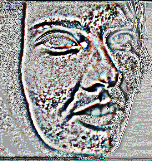

Hi Ron, When I test any algorithm, I like to do this.
1 grain extract before and after,
2 create new from visible,
3 auto equalize.
From this image, you are not only doing skin smoothing, is this your intention?
 Post subject: Re: G'MIC skin smoothing for portrait images
PostPosted: Sun Aug 24, 2014 1:56 am  (#20)
Joined: Sep 29, 2011
Posts: 9
Ron,
I was trying to play with Gaussian Pyramids.
How did you solve 2 main issues:
1. Dealing with both Odd and Even number of pixels.
2. Dealing with the boundaries.
It seems every implementation leaves some artifacts due to those issues.
