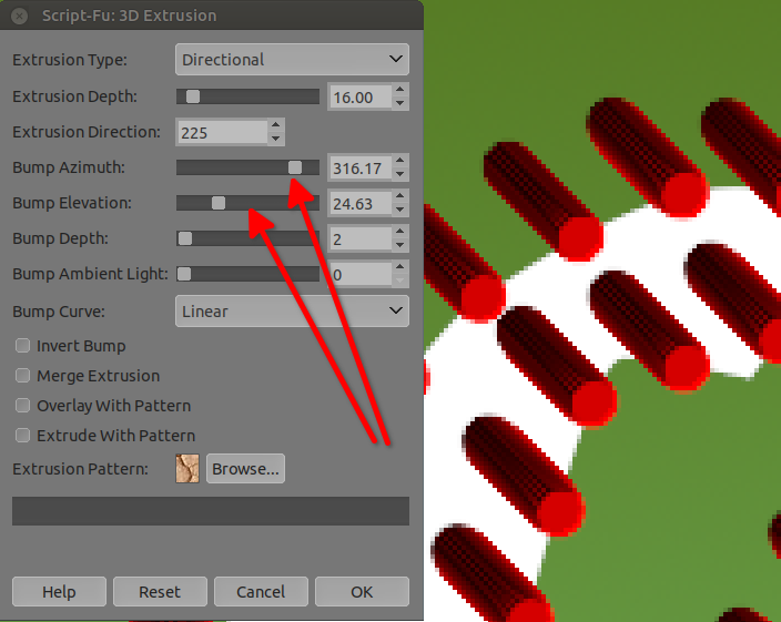

Filter / Render / 3D extrusion
You might want to lower "Bump Azimuth", anyway do as you wish ;)
After extrusion the layer #extrusion is automatically selected -> Re-select "White bump" just above.

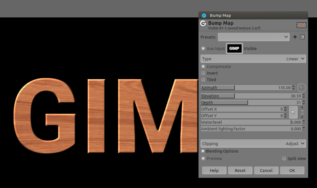

Filter > Map > Bump Map > aux input itself (white bump), type linear, Invert is ticked (compensate and tiled are un-ticked), azimuth 135, elevation 45, depth 15, waterlevel 0.424, ambient lighting factor 0.579
Once the bump map is done:
Click on the FG color and change it to an orange one.
Select the layer "base" (duplicate if you wish) and > put it on top of the layer stack.
Fuzzy Select tool (in add mode or stay on the Shift key), feather edge =1 > select the white, then drag 'n drop the orange FG in the selection.
Select > None
Play with the different Layer blending modes > the burn part works well ("Luma darken only", "Burn", "Linear burn") , Grain merge, divide, HSV color, LCh Color...
Try what fits best for you ;)
Result

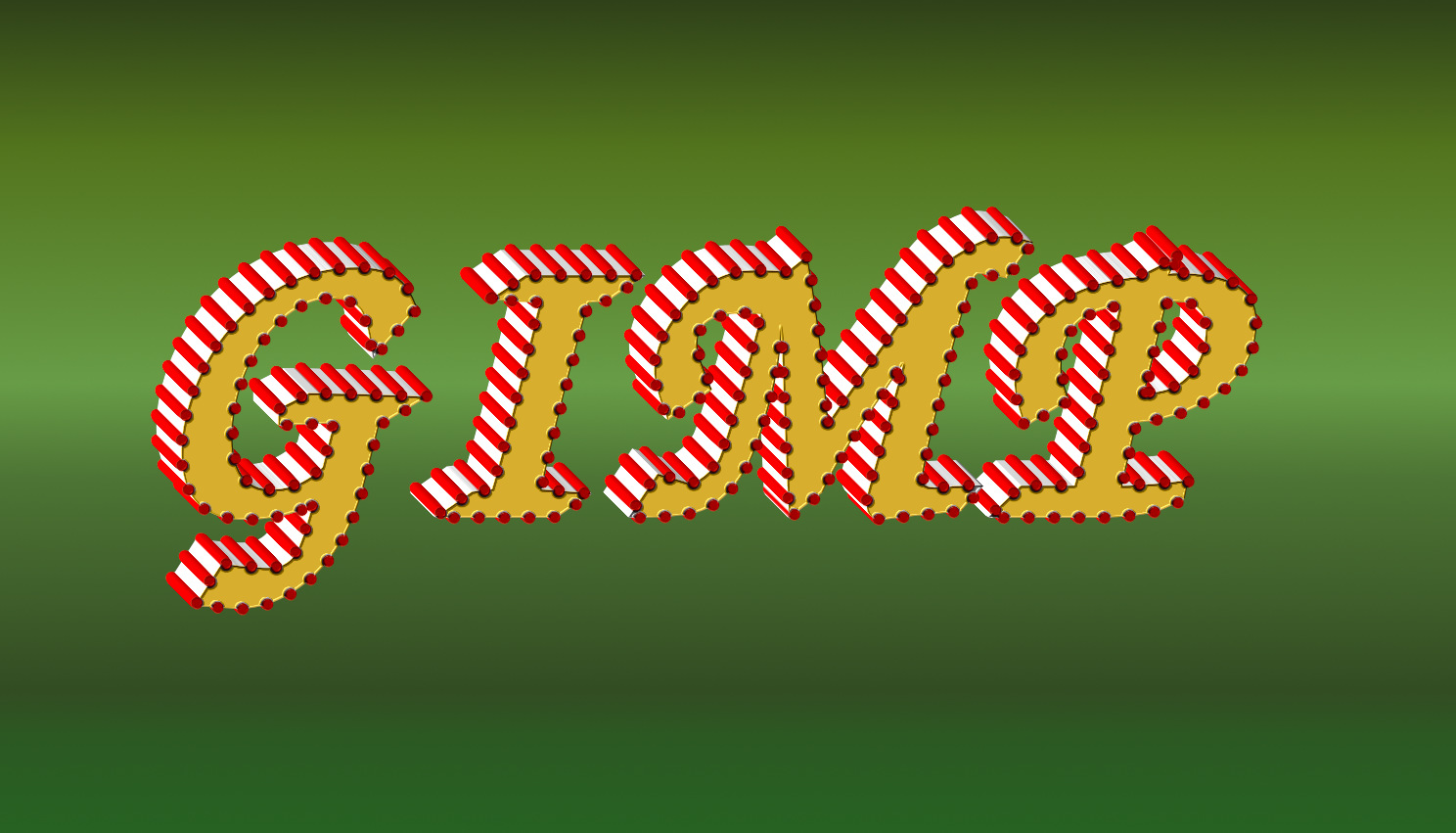

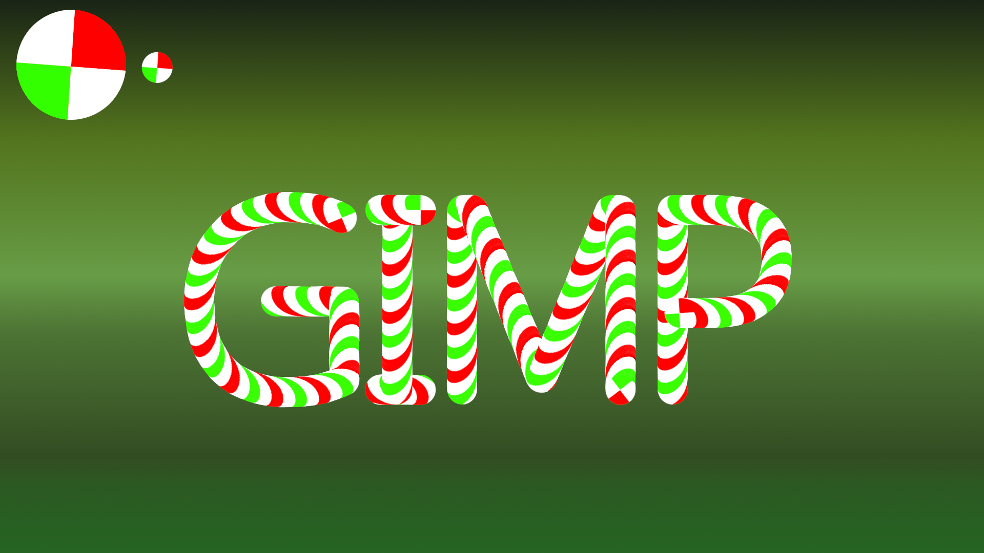

Trying Decoding/reproducing Blitghty II #140
At first I thought it was a "rotative" brush stroke along a path, but the letters C, A, and N are not "similar", but exactly the same.
when you stroke a path you won't have the very-same start and ending colors placement like in this case, unless you duplicate them, but no... I don't think it was duplicated.
In the end I told myself, it might be a special font, script or plugin which I don't have, so I'll do it manually.
During my tests, I also discovered a bug certainly introduced in GIMP 2.10.<12 which add some black to the brush edge, but I did found a way to attenuate it. Not perfect but it seems to work.
Without any further do, let's get stated!
1) Create the brush (easy)
New Layer
Ellipse Select tool > Start to make a circle selection then hold the Shift key down for a perfect circle
Drag 'n Drop the white from the ForeGround(FG)/BackGround(BG) inside that selection
Then click on the FG and set it to red, Click on the BG and set it to green
New Layer
Click on the Free Select tool > Mode subtract and draw a selection like below
Then > New Layer
Drag 'n drop the red from the FG
Then > New Layer
Drag 'n drop the green from the BG
Select > none
Free select tool on that last top layer, put it back in "normal" mode (replace) and draw a selection like below
then Hit that delete button (Edit > Clear)
Select > None
Now you should see the future brush with 3 colors (white, red, and green)
Right click on layer and > New from Visible, or merge together those 3 layers (green > merge down > red merge down> white circle)
-a) Now right click on the finished draw "brush" Layer > Alpha to Selection (do not use any other type of selection tool like the ellipse > because of the bug)
-b) Select > Shrink (6 or more pixels, again to counter the bug)
-c) then Ctrl+C or Edit > Copy
When you Copy something in GIMP it goes to your clipboard > thus it's in your patterns and brushes
Select that brush (Clipboard Image) in your paintbrush tool option on top of the list

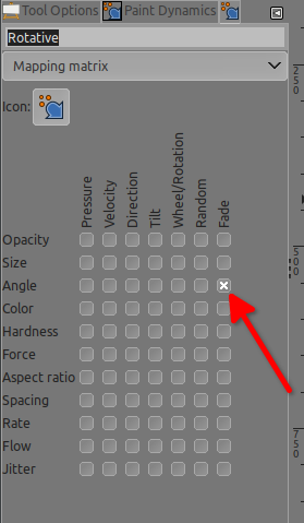

2) Create a new dynamic (very easy) to rotate the brush (4 clicks)
How to make a dynamic brush > viewtopic.php?f=23&t=7208&start=0 (it has 4 images easy to understand)
Click on the dynamic icon > A drop down menu opens
At the bottom right of this drop-down menu there is the same dynamic icon ("open the dynamic selection dialog") > Click on it
A new dialog opens (Paint Dynamics) > At the bottom there is 5 icons, click on the "+" (new), a new dialog opens
Name that dynamic "Rotative" and cross check the "Fade" with "Angle" like below
Done.
3) Paintbrush setting
First thing first: In the paintbrush option do not reduce the size more than 1/3 it's original (the bug... on a rotating brush it looks very bad)
If you want a smaller brush Reduce the layer size with the scale tool for example and re-do steps -a) to -c) and click on the "return arrow" in the brush "size" line to reset the size
Spacing is 1
Hardness 100 (if below... like 75 > it's very ugly > did I said there is a bug...)
Force 50 or below ( above 50-60 = getting worse with that bug)
Smooth stroke is checked, the 2 sliders are at full throttle (100)
Dynamic > "Rotative" brush is selected
Dynamic Options > Fade length ~90 (play with this one) / Repeat > "Sawtooth wave" is selected
It might be long to read, but it takes less than 30 seconds to set the brush up ;)
4) Stroke the text
Text tool > Write "GIMP" or whatever you like Font size > 400 (font use for this exercise is "Noto Sans Symbols Thin")

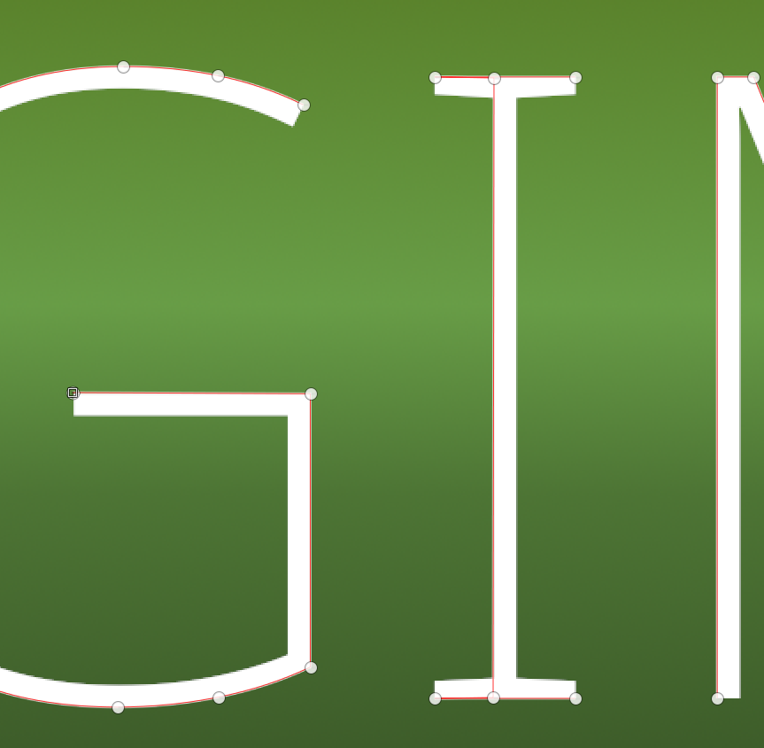

Then right click on that layer > Text to Path
Click on the path tab (dialog), and activate the "eye" to see the path
You are seing that the path is all around each letter, which we don't want.
Click on the "Paths Tool"
Hold "Shift+Ctrl" (during all this operation) to remove the internal nodes and lines, we just keep the outside paths, Click on a node (control point) to remove it, click on a line to remove it
Result (I kept only the external paths)
Edit > Stroke path... (select the paintbrush)
Colors > Levels > move the slider (the one on the extrem right side) a bit to the left to remove those blackish dirty look stripes
Final Result
As always, If you are the OP of this text effect and did use a different method, please feel free to add it, it would be interesting to know how far or closed I was.
If someone has a faster, simpler, or just a different method, please share as well, it's always interesting to know that there are multiple ways. :bigthup
To be Continued...
Patrice

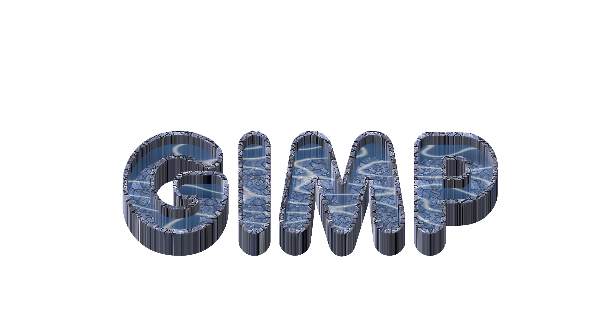

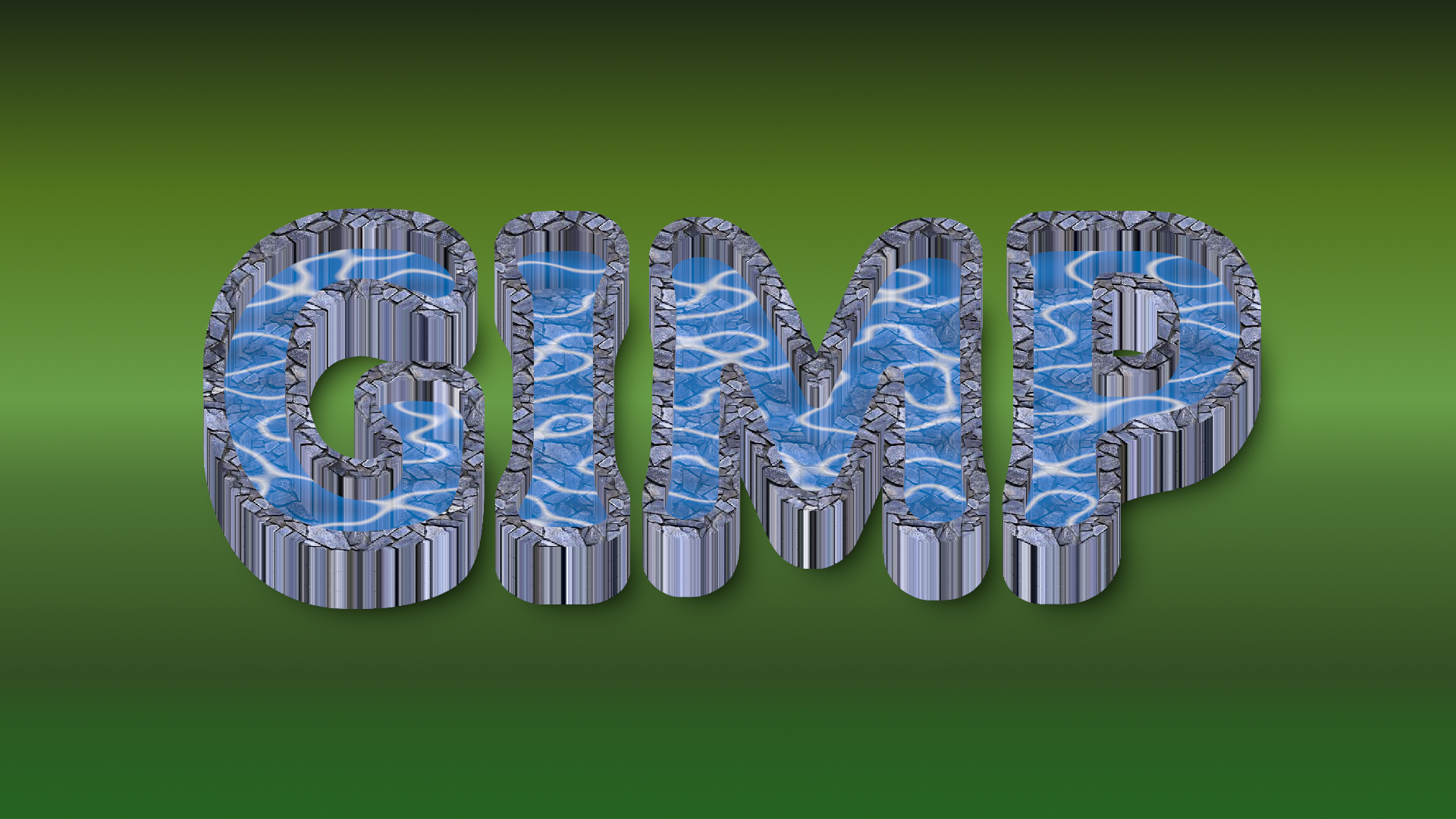

Decoding/reproducing teapot's #204 "pool"
That's a nice one, I like the 3D that this effect gives as volume and container.
The extrusion is neat and I'm almost sure the water effect was 100% generated in GIMP without plugin.
If I think @teapot did the extrusion via the 3d-extrusion.scm plugin, I will not use it for this exercise.
Instead today, I'll show one method on how to do it without plugin, it's not the fastest method, but it's a very simple one and it has a lot of precision and more important > the result is very neat.
Plugins are nice, but let's not forget the basics ;)
Whithout any further do, let's get started
1) Basement
New Layer (name it "bottom")
Text Tool > Write GIMP > Font size ~550 (font used for this exercise is "Averia Libre Bold")
Right click on that text layer > Alpha to Selection
Select > Grow (~17 pixels)
Select > Save to Channel
Un-tick the eye of the text layer (no need anymore)
Click on the layer named "bottom" (not the BackGround)
From your dialog dock pattern, drag n' drop the pattern named "Stone (156x156)" in that selection
Select > Border... (~13 pixels)
Un-tick the eye of the layer "bottom" (to not disturb us for the moment)
Create a Layer Group (name it "bathtub"), it should be on top of the layer stack
Create a new layer (name it "edge") inside the "bathtub" folder
Drag 'n drop the Stone (156x156) pattern from the patterns dialog/dock inside the selection (which has border)
Select > None
Layer > Crop to content (very important before doing anything else)
2) Upper Ground (extrusion)

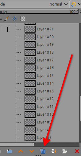

Duplicate that layer "edge" ~25 times by clicking on the "duplicate layer" icon at the bottom of the layer dock/dialog stack (see below)
(Don't do more than 25 times or keep a copy of the layer "edge" - name it "edge.bak" - un-tick the eye, for the future water level with a low extrusion)
Alignment tool > with your mouse > Select (the same way as with the rectangle select tool) bigger than that layer but smaller than the whole image > You should see 4 squarred dots appearing

3) Roof Top (swimming pool)
New Layer Group on top of the layer stack (name it "water")

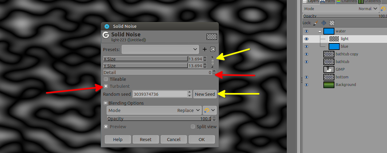

New Layer inside this group, name it "blue" > fill with blue
Above the blue layer > New Layer name it "light" (still inside the "water" group)
Filters > Render > Noise > Solid noise...
Turbulent is checked
Detail is 0
Play with other sliders
Then
Colors > Invert
Then Ctrl+Shift+J (to have the full canvas view width)
Colors > Color to Alpha > click on that white (default color), a window opens (Color), Click in the middle of that big colored vertical rectangle and STAY clicked > drag to the left side and STAY clicked, then go up and down and look at your image at the same time > stop to your liking > then click ok/ok (below are my setting if you wish to use them)
later on, you can resize that layer to shrink it to have denser "reflective" lines.
Click/Select the Layer group "water"
4) The dive (masking water)
Select the layer "bathtub copy #1" > right click on it > Alpha to selection
Click on the layer group "water", then click on that "Add a mask" icon, a window opens > Select "Selection" > Invert Mask is checked > OK
Select > None
Ctrl+Alt+Click on that mask
Fuzzy Select Tool (addition mode) > Click outside of "GIMP" and inside the white in the letter P (of gimP)
Select > Grow (3 pixels)
Drag n' drop black color from the FG/BG
Ctrl+Alt+Click on that mask again (it's a toggle)
Click on the group "water" (to deselect the mask) and play with modes and opacity to your liking like > Normal/50-60% opacity, addition, overlay, screen, hard light, pin light, grain merge and so, > play opacity to your liking
If you want a higher water level, > New group > put that "edge.bak" layer inside > duplicate as needed like 10-15 > follow step 2) for extrusion and alignment > then for the mask use this one
Result

PixLab - ref your post #11 about my Gimp Text process. Well firstly, thanks for giving it your attention and I would love to give you some exact references on my method, however its a few months back now, I did not keep the XCF file and I'm an old guy whose memory is failing :roll: .
Basically it was stroking the path formed by the text and using increased spacing parameters for the standard brush Hardness 100. Then I used the 3D Extrusion filter to produce the tubes.
Good luck with your ongoing detective work.

Oh no - i posted my 204 trial in the text forum ..
PixLab - here is my attempt from your notes, and from links, and from OMG
first i had made one, not deep enough that i was trying to do
then i did make it deeper and i had used two extrusions which ended up not matching
So- finally since i now had the water in the right place in the middle, i just went back to
my initial 'wall' outline layer and did a single extrusion to the right size
(ps- can you tell me if the 'double-post was OK? or is it best to link the posts,
so that there are not double images?)
(LeftyLeo/James)

Decoding / Reproducing racer-x #70 wooden text
I like wood text, this one is what I call a "classic".
We can see that racer-x did use a home made texture, thus we will do our onw ;)
Extrusion was internal going toward the center of the text and there is a "bevel - emboss" on top of it (so we do need to make a map)
Racer-x said "I used Layer-FX and Extrude-3D", so we know how he did it (thank you), thus we will take a different approach as s/he used plugins...
I will use only native GIMP's tool like that every one will be able to do it (and yes it's super easy, reading this tuto will take way longer than doing it ;) )
Without any further do let's get started
New image...
1) Text
Text tool > Write "GIMP" (or whatever you like), Font size 550 > Colour White (font used for this exercise is "Roboto Heavy" from the free Google fonts)
Right click on the layer text > Alpha to Selection
Select > Save to Channel (important)
Un-tick the eye/visibility of that Text layer (no need any more)
Select the Layer below "Background" Name it "white text" > Fill selection with white color
Select > None
2) Texture (2 layers "fibers" and "plank")
This is how I do my quick textures, if you prefer your own, do your own now then go directly to > 3)
Prepare your colors NOW > ForeGround is "d1a07f" / BackGround is "7f5237"
New Layer name it "fibers" > fill with BG color
Then Filters / Noise / CIE lch Noise... Click Ok we just want some noise by default
Then Filters /Distorts/ Wind.. Strenght > Full throttle at max, then OK
---------> [**] Then Filters / Blur / Median blur... > Radius = 1 (or don't blur now but after the next step as it will be more "visual" and you will "see" the "varnish" effect once layer "plank" is made)
New Layer name it "plank"
(this layer is the base of many "quick" textures I'm processing, like stones, water, ice, metal, and so on)
Gradient tool > FG to BG (RGB) > Shape Bi-linear > start from the ~center and drag down to the edge (stay at ~50 pixels from the edge)
Then Warp Transform Tool > size ~300-350 / Move Pixels mode / Interpolation > None (it goes way faster) Abyss policy > Clamp to not have transparent area inside!!!!
Make a mess, you can call your kids to do it, they will love it ;)
Once you've played enough, put the Warp tool on one side (near the top) and go straight to the over side, do the same just below but start by the opposite side, and so on (vice-versa), for two or three more time/row
You should have something like below as a result
Put this layer "plank" in mode "Overlay" at ~78% Opacity (you can play on it with Filters / Enhance / Sharpen (Unshap mask).. if you like a more rough wood)
--------->[**] If you did not blur the layer below this one ("fibers") before, do it now, or don't do it if you prefer a more rough textured fiber-ish wooden texture
Then
Right click on the layer "plank" > New from Visible, name that new layer "Visible" -> "texture"
3) Textured text
Now un-tick the eye/visibility of all the layer below "texture" (but not "texture")
Add Mask to layer "texture", window opens > Select from -> "Channel" - "Selection Mask Copy"

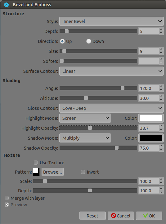

---------> B) For lazy people with the plugin Layer/ Layer Effects/ Bevel and Emboss...
Just take a look at the setting below ;)
Once it's done
Layer > Crop to content (important)

Go to layer "wooden bump" and make it visible
So by now, as visible layer you should have only the black backGround and this one (wooden bump) > select the later(wooden bump)
Filters/Map/Bump map... > Aux Input select the layer "B&W map"> Type Linear > Compensate is ticked > Azimuth 135 > elevation 45 > Depth 25 > Ambiant lithing factor 0.444
Then un-tick its visibility
