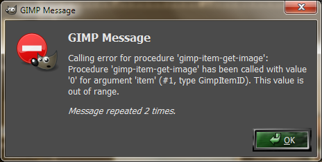

...using sample colorize with current chosen gradient as option? Before I submit a bugzilla, I want comfirmation or better yet, let someone else do so since I tire of getting chewed out. lol

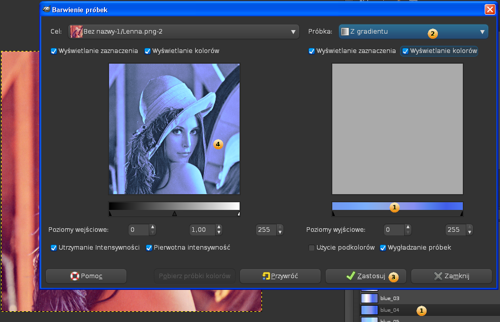

For Win XP 32 Gimp 2.8.1 works well - for 2.8.4 also the same error

Also, the choice of Sample: gradients ?

I know, what the problem is...
But I have to think about it.
When building the box, where the gradients can be choosen, gimp tests, if the items in the list are valid layers.
If not, there will be the message, and the box is rebuild just with the valid layers. But the two gradient entries are no valid layers. That is the reason, why the two gradient entries disappear after the error.
There are two ways to make the plug-in work:
1. The test is cancelled. Thats not good, because if there is a plugin with the layer box and while running the plug-in, a layer is deleted, the plug-in will crash when choosing the deleted layer.
2. The plug-in is rewritten without the gradients, the gradients could be choosen by an other way. Thats good, but it does solve the problem just for this plug-in. Other plug-ins may use valid functions of gimp (like the sample-colorize plugin), and the problem will appear again.
1. I can give you a libgimp.dll with the cancelled test. It will work, but you have to be careful with deleting layers when a plugin is running.
2. I don't have the knowledge for rewriting the plugin. For that purpose I need a lot of time...
3. I have to think about, how to tell the problem to the bug report. And not today (it's late in germany). The problem is deeper than I thought...
I can not believe, that the problem does not exist with linux. It MUST exist or the problem is even deeper...

Right, it does not work with gradients on Windows.
What Onkel Hatti said makes perfect sense.
But it also tells me that there is a simple workaround to the problem.
If gradient is not a valid layerbox entry - create one! Takes an extra layer which you fill with gradient of your choice.

The change was between 2.8.1 and 2.8.2. It was a fixed bug, where plug-ins (python) crashed, if there were layers deleted while the plugin was still open.

I proposed a patch for the error.
We will see, what Mitch will say to it...
The error is not in the plug-in, but a function in libgimp/libgimpui. It's not a real error, but it is 'not nice'.
My suggestion for gimp programmers is:
If there is used a selection box with entries for layers, drawables, etc., DON'T mix it with own entries. With my patch, it should be possible, but again, it is 'not nice'.
