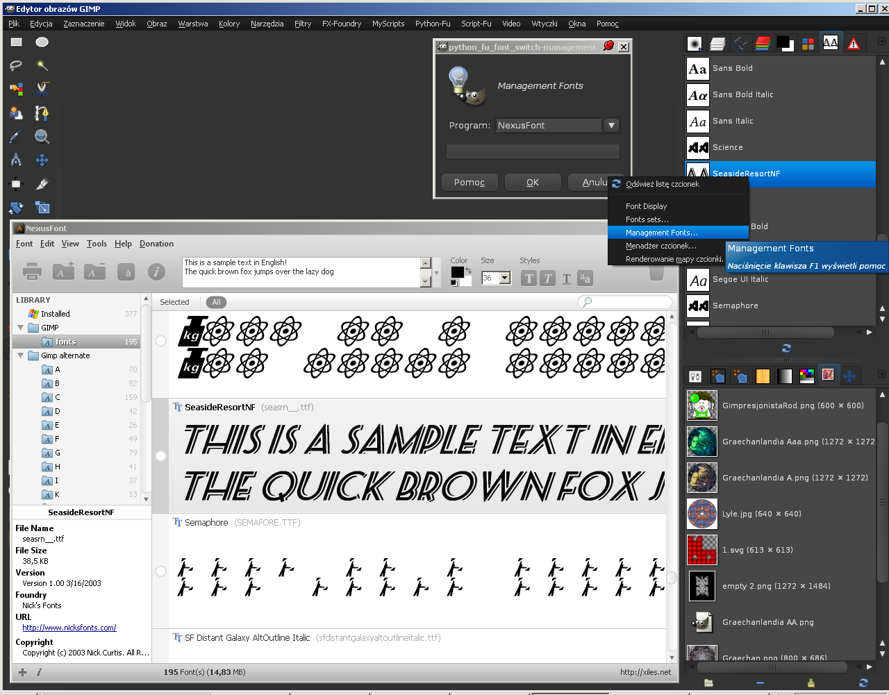

Just a reminder - this is an alternative (z małą zmianą:Fonts -> [ PPM - contex menu] -> Management Fonts...):

@ MareroQ:
Pardon my ignorance, but I know nothing about scripting. If I put this in the plugins folder, after editing my path to Nexus Fonts, it will allow me to use Nexus Fonts with Gimp? I already have Nexus Fonts all set up with my fonts, so it'd be much easier. I'd appreciate your patience and help with this.

1. Download and unzip Switch Font.zip.
2. Switch Font.py is a plugin (which requires that you have Python - how? http://www.exp-media.com/content/extending-gimp-python-python-fu-plugins-part-1).
3. Place the Switch Font.py in the appropriate directory (how? http://gimpchat.com/viewtopic.php?f=8&t=719).
4. Open the file Switch Font.py in Notepad + + (http://notepad-plus-plus.org/download/v6.4.2.html).
5. Check lines 15 or NexusFont.exe located in this path: C: \ \ Program Files \ \ NexusFont \ \ NexusFont.exe - if NO - EDIT the program directory path NexusFont.
6. Restart Gimp (if it was running).
7. The GIMP-click PPM on any font.
8. In the dialog box, select Management Fonts ...
9. In the new window-management python_fu_font_switch Select program NexusFont
10. If all goes well the Nexus is booting up.
11. Share your fonts into groups [A] - PPM menu NexusFont - You can add any fonts in Gimp (C: \ Documents and Settings \ YUR NAME \. Gimp-2.8 \ fonts \) - an advantage -[b] that choose a font that you can see.
12. Reload fonts in Gimp and you can use it (without restart Gimp).

@ MareroQ: Thanks for the detailed explanation. Will try it again when I have a few minutes to mess with it.
