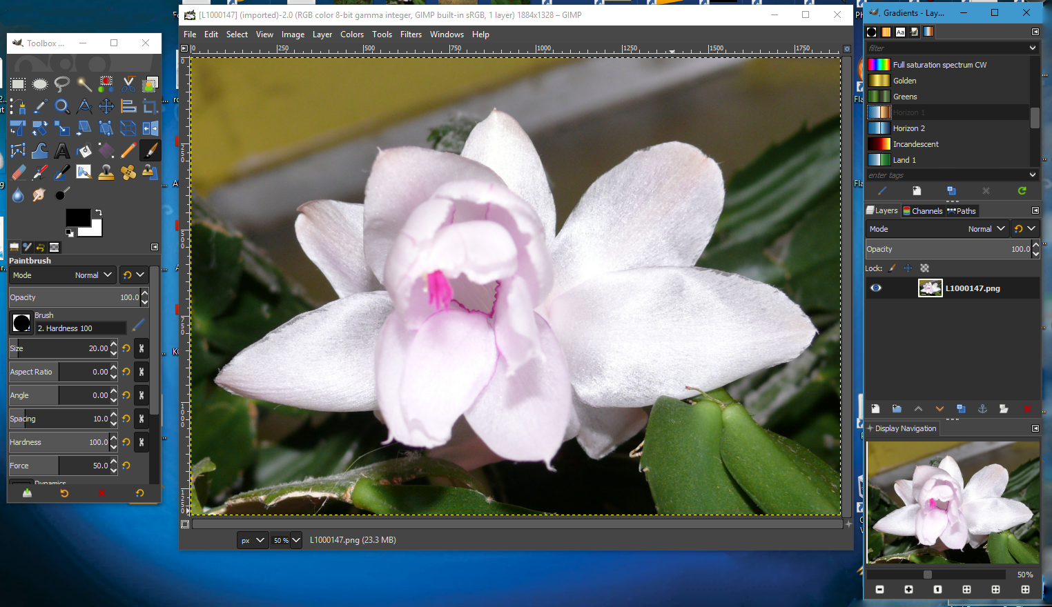

OK; decided to include my modification of samj's interface. I know; old school old fogy I am. lolol
edit: did have to reconstruct the gradient tool icon (not hard) since it was missing. :)

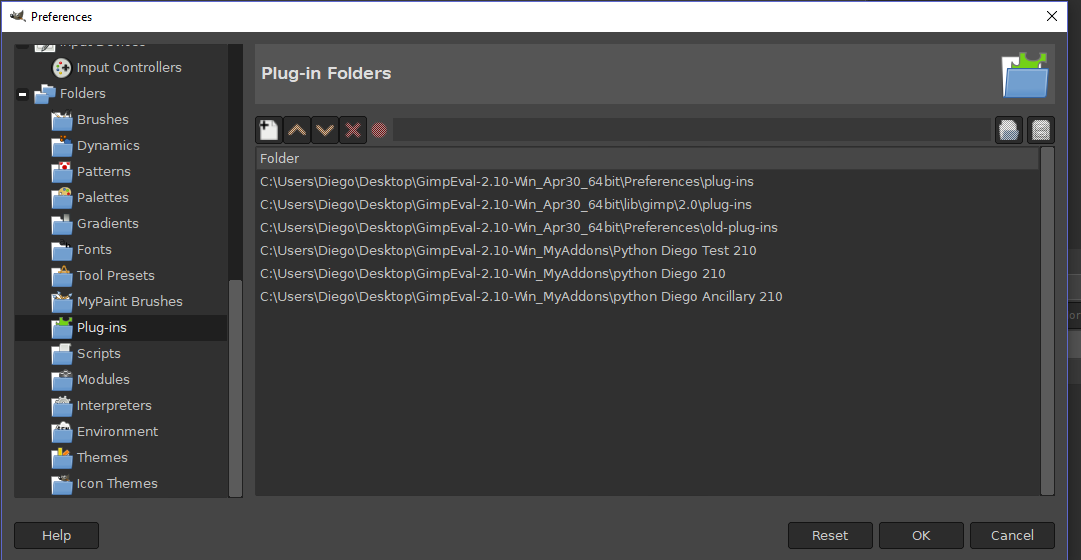

Posts: 14816
oldmangrumpy wrote:
Lyle - thanks for your help. However, another 60 minutes of trying to get the Samj version operational with all my current filters (both python and scheme) available failed miserably.
I copied the program from USB to hard disk, then ran the new GIMP, in which I modified all the folder names in preferences and restarted expecting to see all those friendly filters ... but no. GMIC was there but now I give up.
I must be missing something in the process or just do not understand exactly what is required. I will stick with GIMP 2.8.22 for a while.
OMG, do NOT change the names in Preferences, just add the links to your plug-ins folders, look:
As you see I added 3 of my folders (so far only those "ported" to 2.10, but you may add others, Gimp 2.10 runs in "compatibility" so many of the old filters even if not ported do run, but not all)

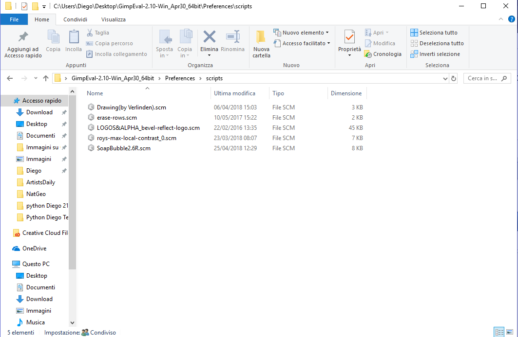

PS: the scripts should be inserted into the folder Preference/scripts, look:
I just added the few I am testing for my porting activity, you may add almost all your scripts, many will work
