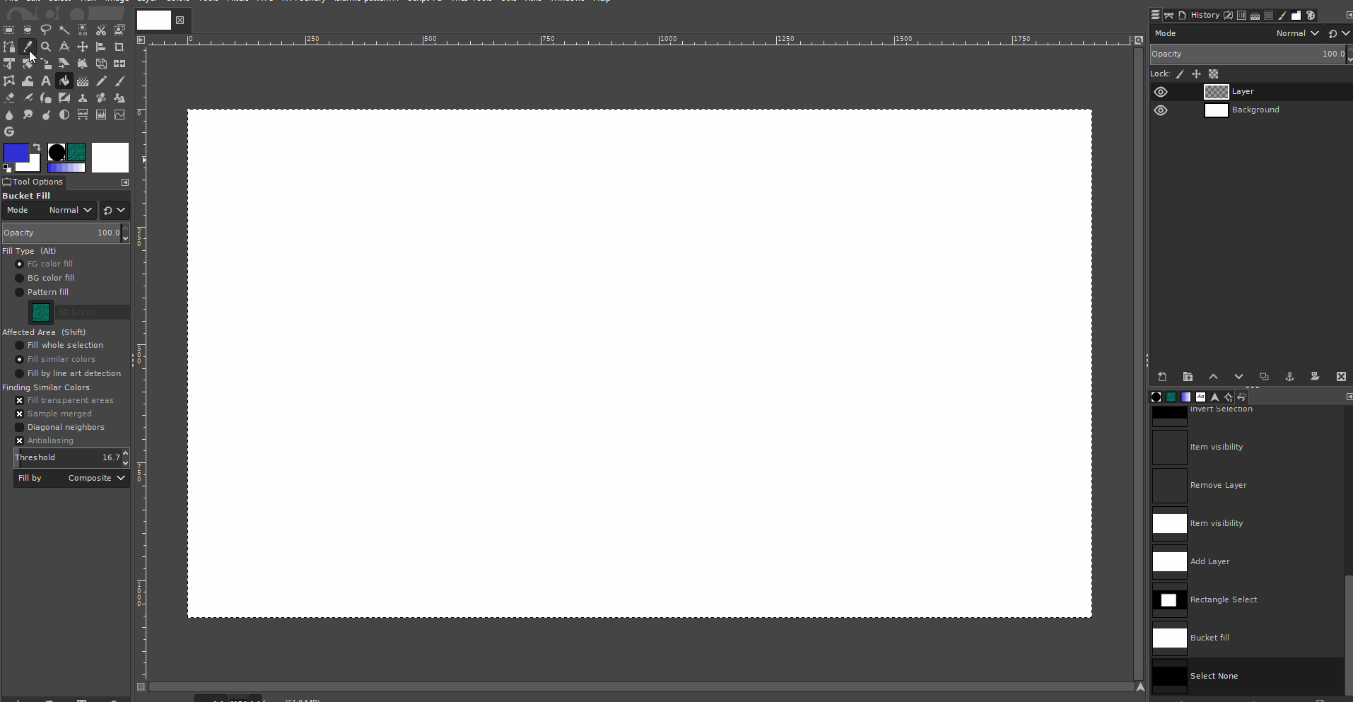

Hi, When i make a selection then invert it i get the same thing, sometimes the screen shows no selection sometimes random lines like yours, I've just updated everything i can & reloaded Gimp 2.10.10 ?

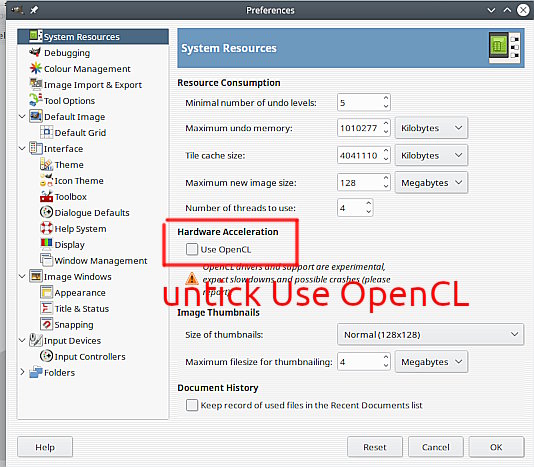

Try Edit -> Preferences -> System Resources
Under Hardware Acceleration disable Use OpenCL
Restart Gimp, see if it makes a differnce.
 Post subject: Re: weird lines with selection inversion
PostPosted: Wed May 15, 2019 2:34 pm  (#6)
Joined: Mar 02, 2018
Posts: 25
Thanks rich2005, Yep that seemed to work
