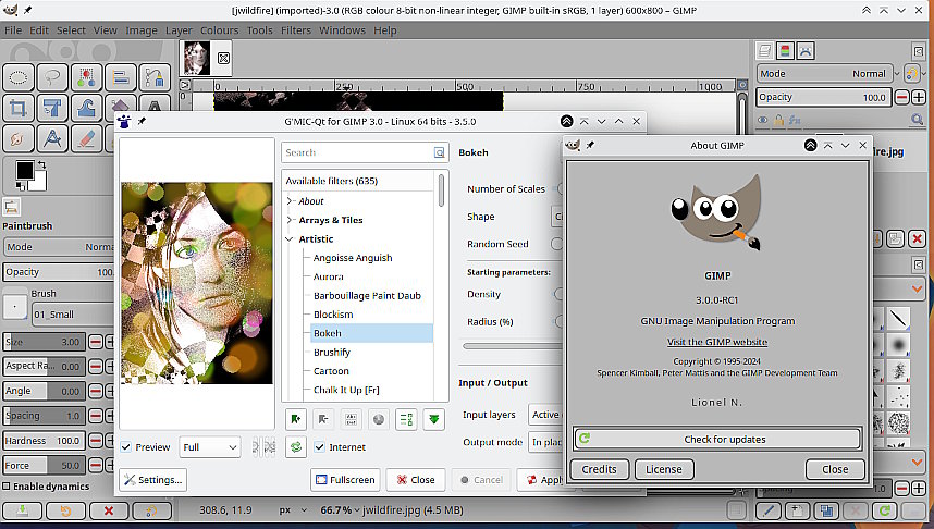

This my old kubuntu 22.04 laptop Using a pixelmixer theme and a Gimp 3.0 gmic_gimp_qt

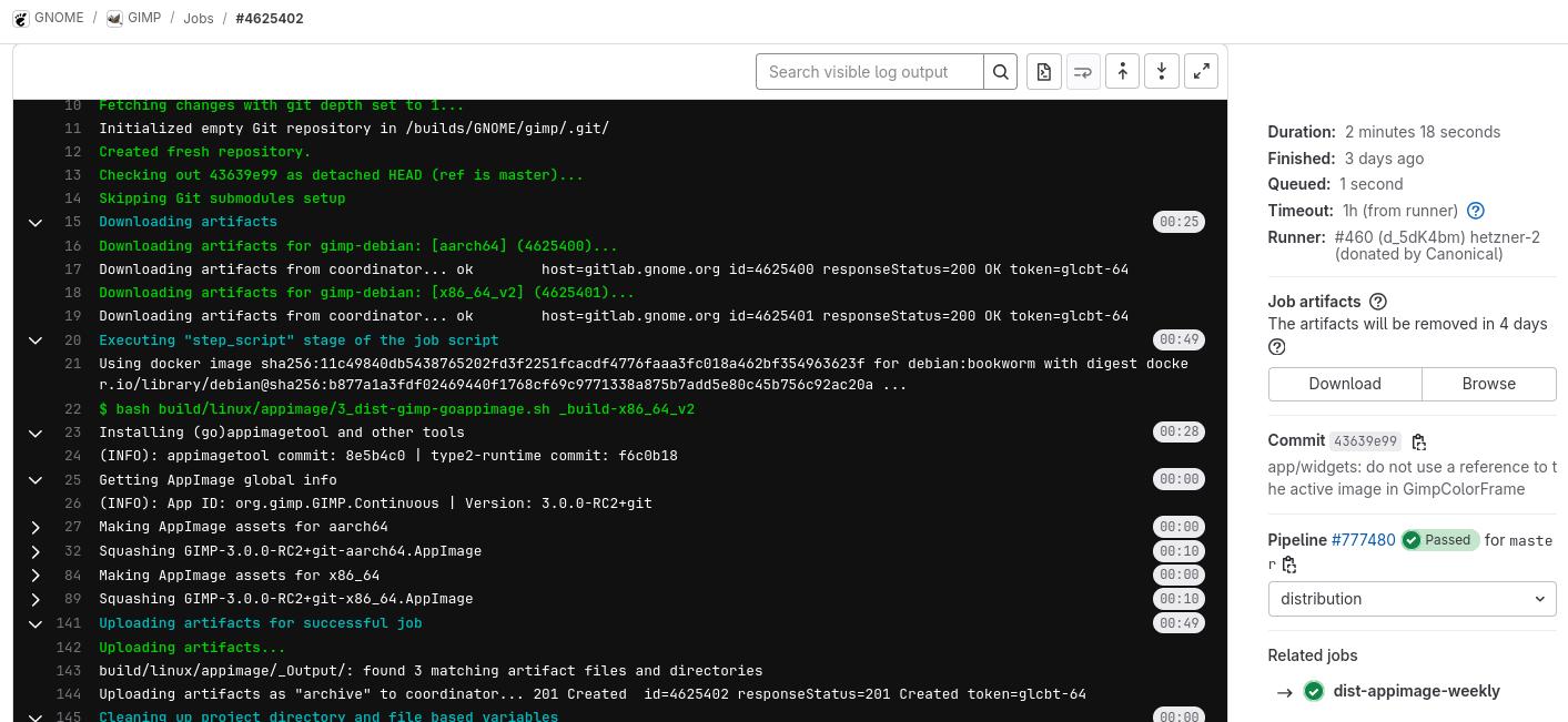

and the "official" Gimp 3 currently https://gitlab.gnome.org/GNOME/gimp/-/j ... e/_Output/

Hi Erisian. The Gimp dev team now make up to date AppImages so I no longer make them. That was just a Gimp3 experimental. I support the fact Gimp now do AppImages, it should have happened a long time ago.
They are listed on the Gimp development downloads page
and you can find them here.
That page is is here and it changes weekly.
Click the 'Download' box on the RHS and you will get the current. RC2 now and as up to date as the source :)
