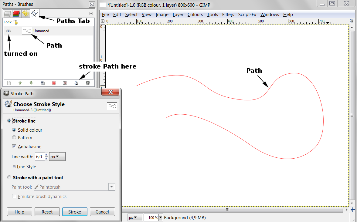

as usual bredies, all these questions could be answered a lot easier if you told us what you are actually doing and attach the picture

dunno maybe the xcf was too big, try zipping it next time, to make it smaller (you need to have a program for that, like win.rar or 7zip)
the screenshot is really helpful !
so you have three paths, none of them stroked, as it seems, thats why nothing is there when you export it
a path is not a drawn line, it is more something like a blueprint for something that could be made into a line
in order to get a line, you have to stroke the path
my suggestion: create three new transparent layers and stroke each path on its own layer
if you dont know how to do that, have another look at the screenshot i made for you
or check this link:
http://docs.gimp.org/en/gimp-path-stroke.html
afterwards merge down all layers, then export (not save ! save only saves as an xcf-file) to whatever format you like
for more infomation look here:
http://gimp.open-source-solution.org/ma ... atten.html
http://gimp.open-source-solution.org/ma ... -down.html
png is lossless but at the cost of bigger size, jpg is smaller but not so good quality

i don't think you're trolling, i think you're unused to gimp :). you seem to have a new transparent layer open, that's good for putting your stroked paths on. make sure that layer is active, i.e. check that it's highlighted in the layer tab. then go to either the layers tab or the edit menu and click "stroke path". you will get a dialog box with stroke settings, the simplest thing for your purpose would probably be the top option in that dialog box. before you stroke path, however, make sure that your foreground colour isn't set to white this time, because what i tried (and obviously failed) to communicate earlier was that your path is there in the picture you posted, it's just that it's been stroked with white and obviously doesn't show against the background. then, if you're happy with the result, you should probably first save a copy of your picture with all the layers (to be able to edit later if you have to) and then merge all layers and export it as jpg or whatever format you're using.
