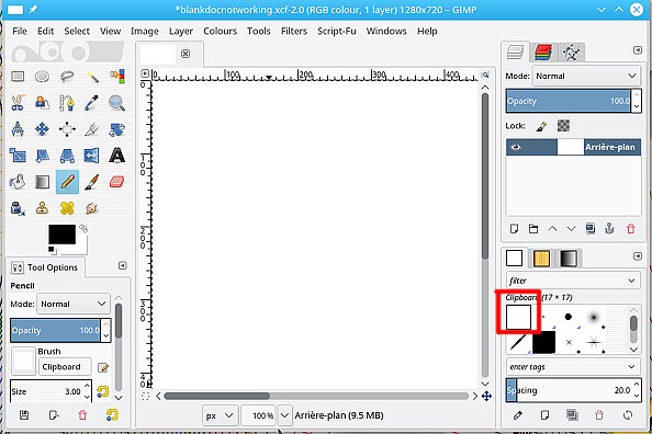

I currently have an issue with the brush and pencil tools, which do not draw on the only layer of my document (which is weird because the bucket does work).
Apparently it is a pretty common problem so I've tried many things but none of them worked.
Did you try this common problem - using an empty clipboard as a brush

Thank you very much for your help Rich2005, now I'm able to draw again!!
