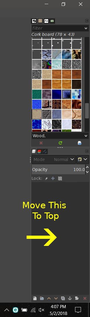

I'm trying to rearrange my Gimp 2.10.
The default installation put the dock of brushes and patterns on top of the right hand side.
I would like the the picture I open and layers there.
I've tried dragging and close tabs but it stays firmly put.
Can it be moved from the bottom to top ?

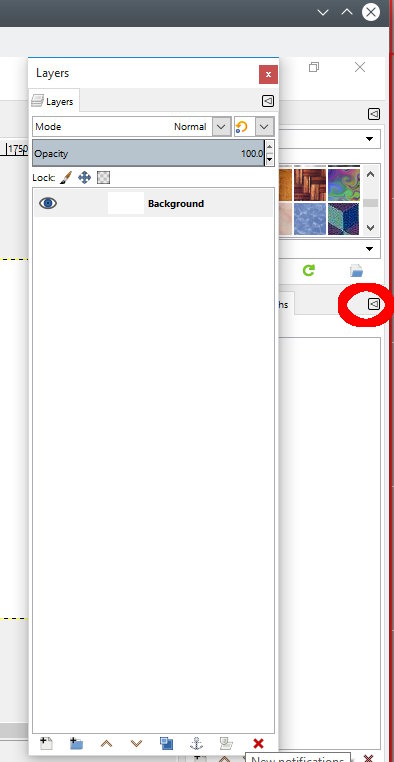

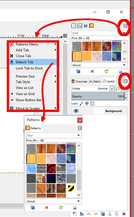

OK, not the way to do it. Wallace shows in his screenshots, not easy to see in that dark theme, so look for those little left pointing arrows which bring up all the settings. One of them is detach tab. That is the one you want.
No point detaching just the patterns, it is replaced by one of the others and the layers dialogue is still the same size.
Detach the layers dock and size it as big as your computer display. However It will obscure other parts of the interface unless you move it outside the Gimp window.
Note: you can do all that easily click-n-drag.
