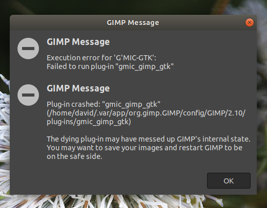

A little more help required if possible!
I came to use Gimp 2.10 flatpak and when I tried to use G'MIC Gtk I get the attached error message.
If I open Gimp from the terminal there is no indication of missing files.
(Running Gimp under Ubuntu 18.04.)
I have not changed anything on the machine and it was working previously.
david.

Posts: 2419
Still working here (k)ubuntu 18.04, Gimp 2.10.6 flatpak, gmic_gimp_gtk https://i.imgur.com/TR9QLs2.jpg
Was working before, not working now, you did not change anything. Something must have changed.
Is your Ubuntu 18.04 doing unattended upgrades? Almost as bad as Windoze. see: https://www.omgubuntu.co.uk/2016/02/how ... ate-ubuntu
If the org.gnome runtime has been updated then those 30-something lib files will need reinstalling.
Otherwise do not know.

Joined: Nov 15, 2014
Posts: 866
rich,
Thanks for your quick reply. It was actually an Ubuntu problem - various other programs were not working, so yet another re-install!
I decided to drop Gimp 2.8 and just install 2.10.
