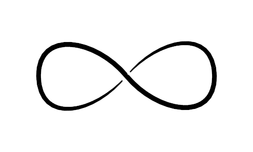

Hi all,
How do I draw an infinty symbol, in Gimp, whose lines get narrower towards the end (example attached).
I'm not very good with the pathtool :pathtool

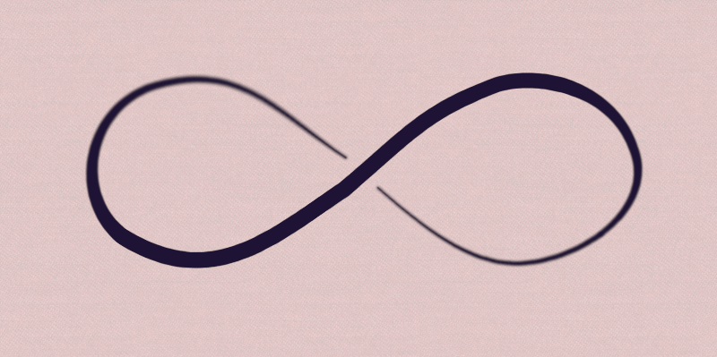

Ella - here is a ' two minute quickie' - yes, using paths and a brush with 'fade to fade' dynamic, which delivers your narrow ends. Happy to deliver an xcf file to you if this is what you are looking for. :)
If you want text as well then it becomes a more tedious job - like 5 minutes.

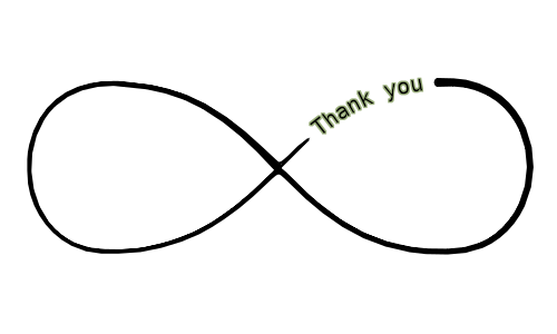

Oldmangrumpy, thanks for the explanation and willingness to provide an xcf-file. In my humble opinion, using the fade-to-fade option blurs the line of the symbol.
Rich2005, thank you too for the explanation, the plug in and making the video. At least it helps me with using the path tool. But also I think my example was created with a vector program, like Inkscape. I use that too from time to time. Drawing with paths still remains a bit difficult for me. Keep practising, I suppose :paint

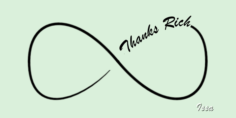

Thank you Rich. Thanks Ella. :clap :tyspin

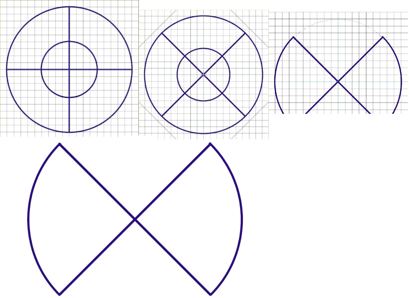

 Post subject: Re: How to draw an infinity symbol
PostPosted: Tue Jun 13, 2023 2:18 am  (#9)
Posts: 12705
Thanks ananniamul. Welcome to Gimp Chat. :)
I've tried to follow your explanation. Is this sequence what you say?
What is useful the second circle for? Thanks.

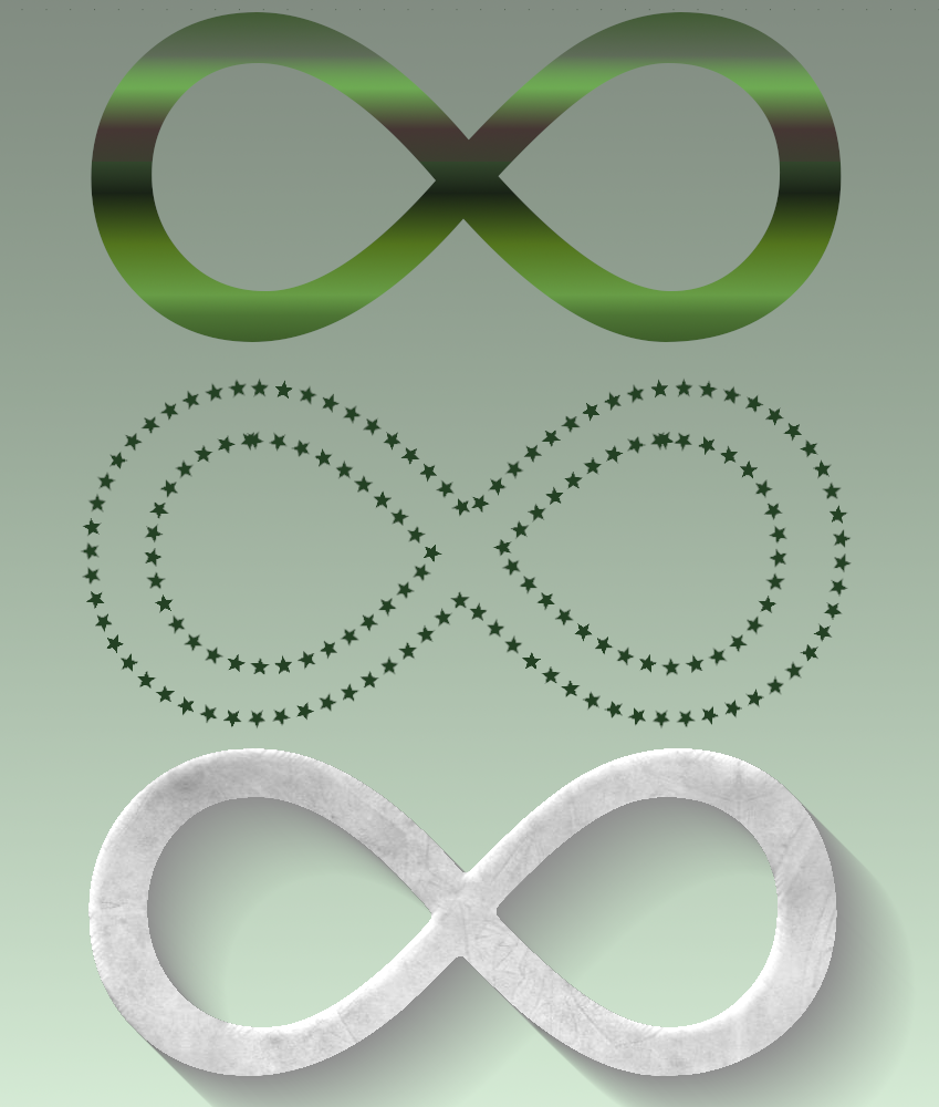

I used a unicode character as a template when I played on 'More than just a Pretty Font'...
Unicode information

Hi Ella - I am sure that you will manage somehow but try this if you have a moment.
Open Gimp and add a new image - perhaps 1500x1000.
Open the webpage with the unicode symbol.
Put your mouse pointer over the large infinity character and drag across to select the character.
Copy the character (right click and copy or Ctrl + C or whatever key combination you use to copy).
In Gimp...
Set the active font to one that you know a word processor would use - Times New Roman, Helvetica, Courier, Sans Serif are some that have this unicode character.
Make the text tool active (so that you have the text tool options available).
Set a very large size - say 800.
Click on the gimp canvas to apply the text tool and press Ctrl+V (or whatever key combination you use to paste with) to paste the unicode infinity character.
Now it's available to use as a template in Gimp.
Examples below:
