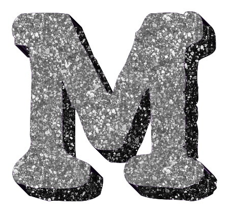

I've been playing around with trying to get a "rock-like" look to some text that I want to have a 3D look as well. I tried extruding the text and applying texture but it just doesn't look right. I've tried several approaches and nothing seems to look right. Anyone have any ideas? I'm having a brain cramp trying to figure this out.
Here's the pic I'm trying to make with the extruded text. It's the extruded part that needs to look like the rock face and still have that 3D look.

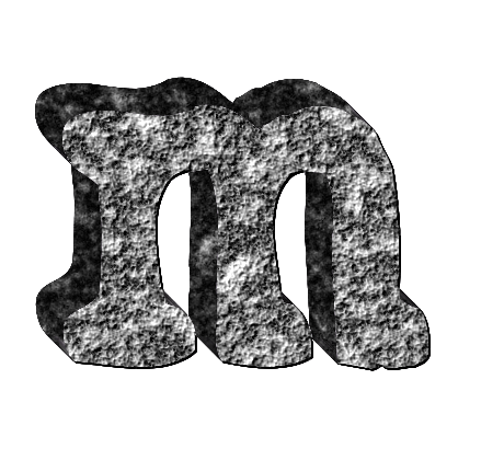

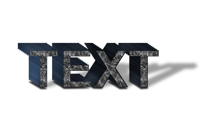

Draconian you can acheive this effect by duplicating your rock patterned text a bunch of times and moving each layer underneath the same direction (x and y)
Then merge all the layers except the top text layer and your white bg layer.
Make the top text layer invisible.
Now run Colors/Curves on the layer that contains all the merged text.
A slight downward bend just to darken the bevel a bit works fine.
Make the top text layer visible again.
You should now have
top text lighter layer
a darkened 3-D layer
a white bg layer
Keep in mind you can use this effect for shapes also.
Example

You can get a ridged look on the bevel by simply erasing some parts of the text edges BEFORE duplicating the text.
Example

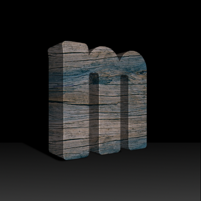

Another G'MIC extrusion: (Hint* After running 3D extrusion with Phong, duplicate the result and run Posterizer at 2 colors, to convert the duplicate to black and white for making Paths from selections. Then follow up with Rod's advice. I tried GnuTux's advice on bump-mapping and I have to admit that only works on very specific items. It didn't work on the brick or rock patterns, at least not for me. Although I am certain there is right way to use it and I just haven't found it.)
I did this the hard way! GAH!~ :gaah
You can add texture pattern layers in G'MIC when using 3D extrusion:

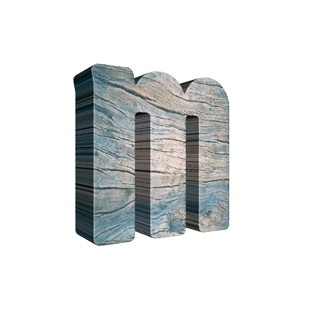

There's a script that does what Rod suggested, called Drawable Multiplication. It can be found here:
http://registry.gimp.org/node/22383
Using Drawable Multiplication is super fast:
Tossing in a bump, reversing the stack order:
