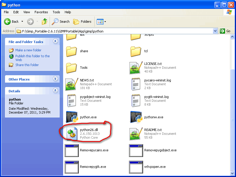

Hello!
I had previously asked this question in another thread. I'm having problems getting this to function (at all). Below is the original question and replies.
http://gimpchat.com/viewtopic....#p41379
Rod had instructed me to do the following:
I did it once before. :)
Just add/copy the entire python 26 folder from (C:\python26 )
into the App/gimp folder. rename it to just python
Now you need the python folder from the lib/gimp/2.0 folder in the installed Gimp-2.6.11
Copy that to the \App\gimp\lib\gimp\2.0 folder in your portable version.
copy the pygimp.interp and pygimp.env files from the installed gimp-2.6.11 ...
Copy those two files to their respective folders.
If i remember correctly you will also have to start Gimp portable from the execute file in the bin folder. :)
Otherwise it doesn't see the Python26 folder in the portable directory.
Try them both though i could be mistaken.Like i said it's been a while. :P
I stand corrected - you need to edit the pygimp.interp to the exact path you have for python execute
And you need to launch from the portable icon (not the bin exe)
my pygimp.interp looks like this for instance
python=F:\Gimp_Portable-2.6.11\GIMPPortable\App\gimp\python\pythonw.exe
/usr/bin/python=F:\Gimp_Portable-2.6.11\GIMPPortable\App\gimp\python\pythonw.exe
:Python:E::py::python:
And I've done that:
Note: My flash drive on my PC is my 'G' drive.
Copied the python26 as python to G:\PortableApps\GIMPPortable\App\gimp\python
Next I copied the python folder from the lib folder that was in the PC install of Gimp
(C:\Program Files (x86)\GIMP-2.0\lib\gimp\2.0\python)
I then copied the interpreters & environ folders from the lib folder that was in the PC install of Gimp
(C:\Program Files (x86)\GIMP-2.0\lib\gimp\2.0)
I then edited the pygimp.interp file to reflect my PortableApps python files as such:
python=G:\PortableApps\GIMPPortable\App\gimp\python\pythonw.exe
/usr/bin/python=G:\PortableApps\GIMPPortable\App\gimp\python\pythonw.exe
I then copied files that had .py and .pyc from (C:\Program Files (x86)\GIMP-2.0\lib\gimp\2.0\plug-ins) to my PortableApps install plug-in folder (G:\PortableApps\GIMPPortable\App\gimp\lib\gimp\2.0\plug-ins) **NOTE: this is NOT the folder that holds 'user' or additional scripts/plugins
I then fire up Gimp from G:\PortableApps\GIMPPortable\App\gimp\bin\Gimp-2.6.exe. I've pasted in the console-messages in verbose mode. There are no errors. But python does not load as there is no Python-Fu in the filters menu.

You are missing one crucial thing the python26.dll needs to be in the App/gimp/python folder :)
Do a search for it and add it to that folder.Search the windows/system32 folder.Copy it from there (don't move it)
Rod, my python26.dll was in C:\Windows\SysWOW64. I have Vista 64-bit OS. I still copied this file to that location and started gimp from the 'bin' directory. No python-fu in the filters menu. :(
