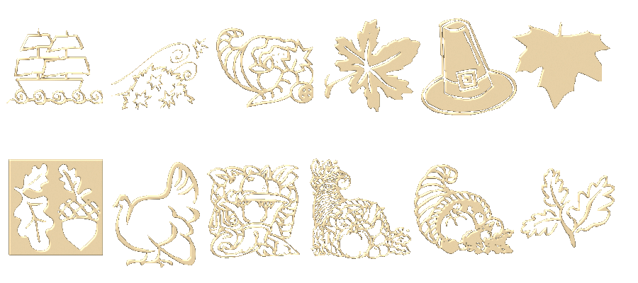

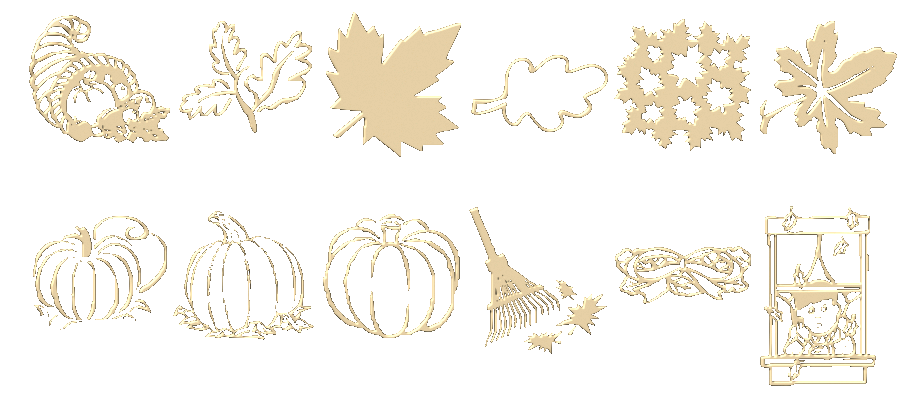

didnt seem to be a problem with these

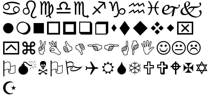

ok common wingdings here
