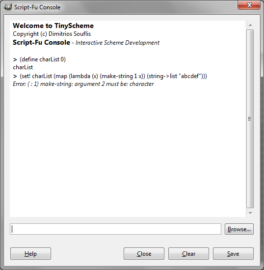

Looks like it's failing on make-string for some reason...
Photomaster,
wanna try something for me?
Go to Filters -> Script-Fu -> Console
Enter
(define charList 0)
Then
Enter
(set! charList (map (lambda (x) (make-string 1 x)) (string->list "abcdef")))
see if it runs...
that's essentially what the script is failing
TinT

This is what I got to running the script commands. I am going to try the removing scripts idea.

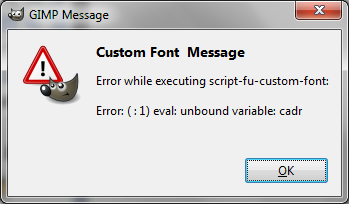

I removed all the scripts from C:\Users\PhotoMaster\.gimp-2.8\scripts and from C:\Program Files\GIMP 2\share\gimp\2.0\scripts
leaving only custom_font.scm and I got this error message.
My Sigs = My Photos
 Post subject: Re: Custom Font script (spawned from Wallace's PhotoFont topic).
PostPosted: Sat Feb 18, 2017 5:38 pm  (#360)
Posts: 3975
just try removing script from
Not from
because those need to come with GIMP.
Now it's complaining about basic functions, not good.
