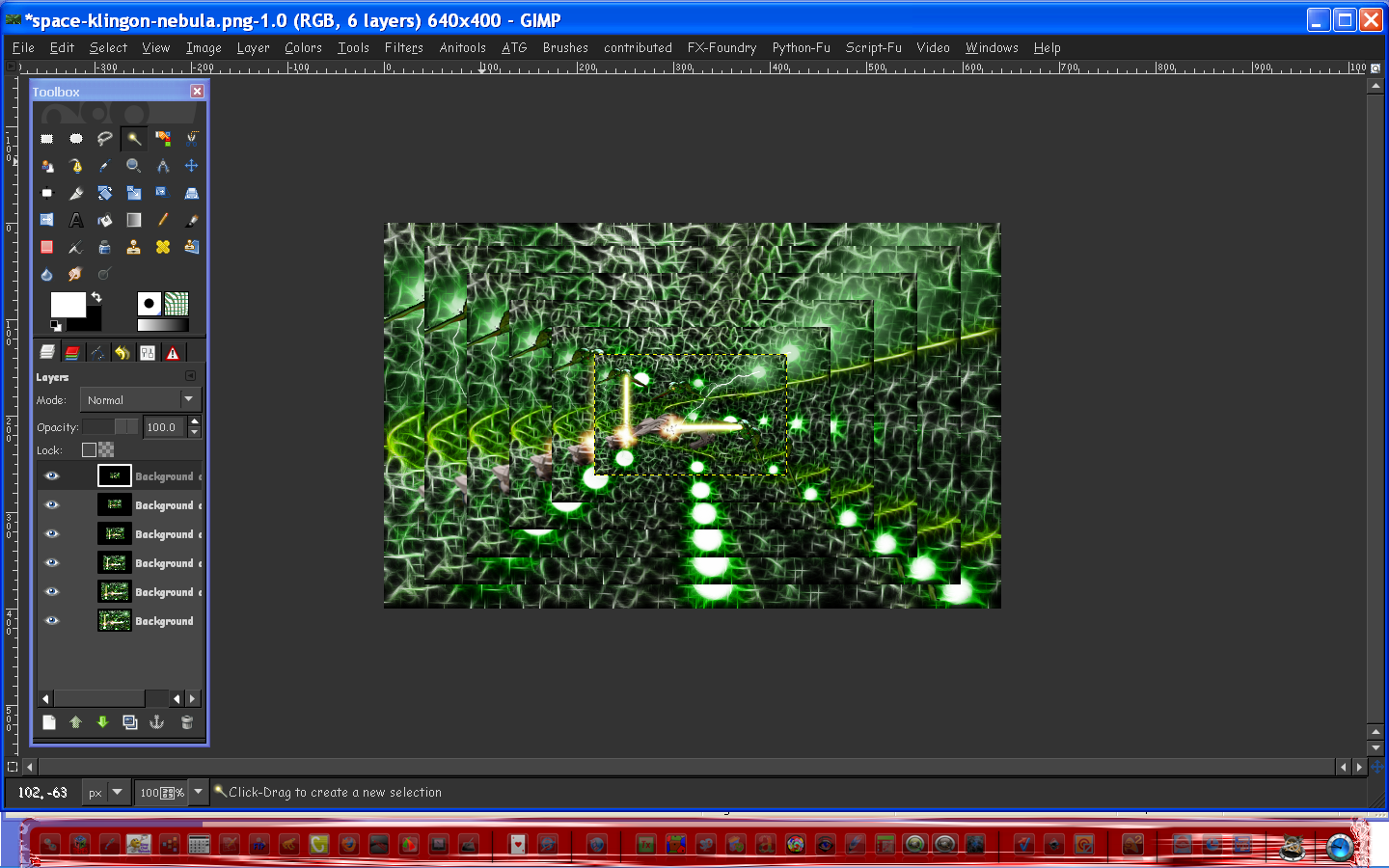

PostPosted: Sun Apr 03, 2011 6:50 pm  (#5)
Joined: Jul 14, 2010
Posts: 697
This does it:

   SF-ADJUSTMENT   "Numbers of steps"   '(10 2 20 1 1 0 0)
 Post subject: Re: FU-stair-resize.scm

Posts: 14709
Location: USA
RobA wrote:
This does it:

Excellent Rob! Exactly what i needed.
PC i couldn't get that to work for me i got 10 layers of all the same size images...sorry.
it works i am sure i just am not doing it correctly.

Awesome Willy!
Yeah PC this is what i was needing.But not for a tunnel effect which does look pretty cool.
I wanted to be able to create a bunch of different sized images on the same canvas for printing. :)
Now after running the script i can just rotate each image and enlarge the canvas to accommodate.
Picture Package works good for this except it creates 2 of one size and 3 of another on the same canvas.If i could have edited the code for that plug-in to add some settings like 1 this size/1 this size/1 this size - then it would have been okay.
This script is exactly what i needed to accomplish my task.
Thanks again Rob - Golden award is on its way! :P

And I thought I was a script head :lol
Looks good Rod very cool animation :D
