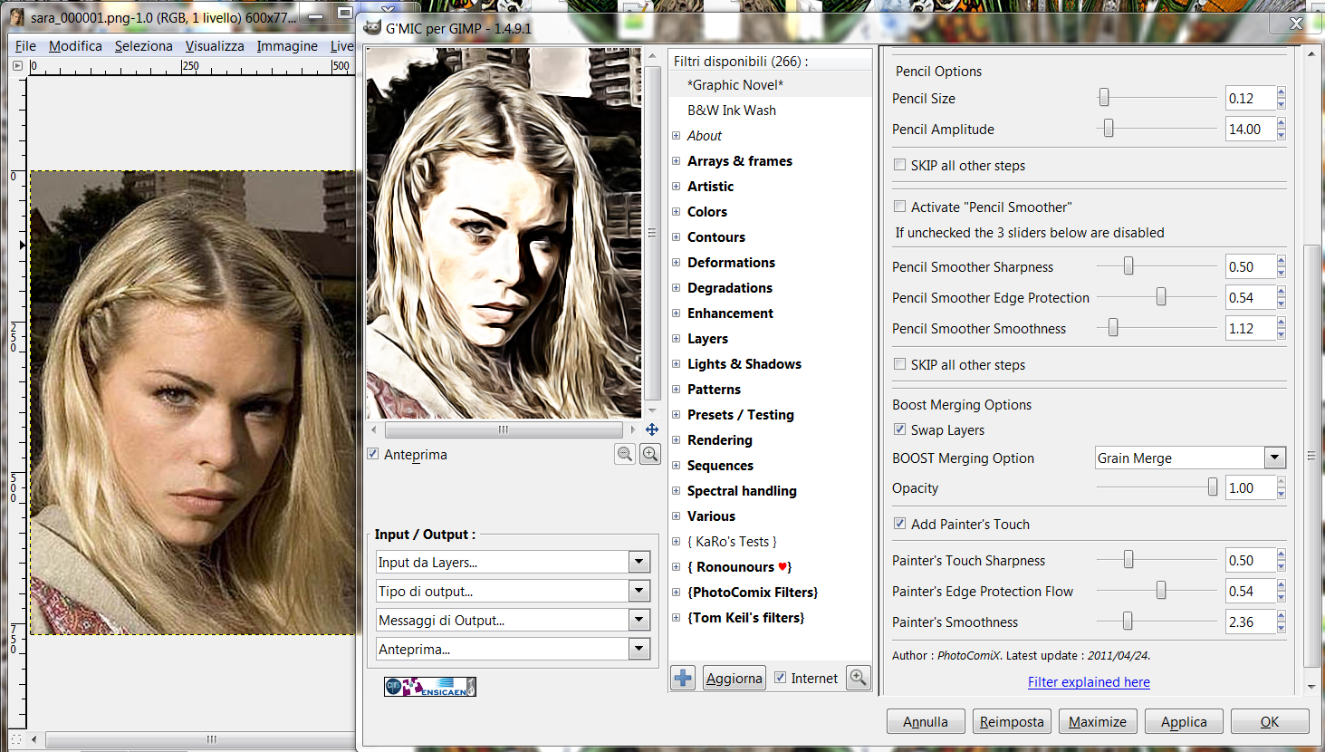

First a good news for who has old preset from previous version, i recover the code on which were based, so i may update soon to the new version , and in the while i may repost the old code
(as usual the 2 version will not conflict )
New version changes
1)
now is possible visual control on each step :
Check "Skip all other step" box allow to see what are you doing, instead then the final combination.
Anyway remember to Uncheck to reactivate the other controls.
2)
Merging modes:
i add a option to swap the layers before merging
and 2 merging option
please let me know if any problem
BTW i removed most of the notes in the filter for problem of space, let me know if is still clear, if not i may add them again (but then will be needed scroll even more to access to all commands)
To get the filter open Gmic enter in About/additional Filter menu ,there enable my source (PhotoComix Filters)...then click for filter update
