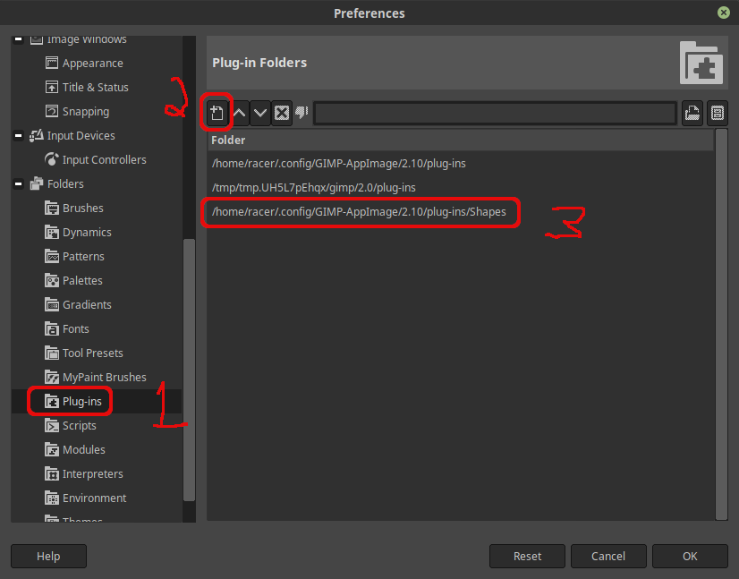

racer-x wrote:
The "Arakne's path shape creator" is working OK here in Gimp 2.10.8 running Linux. I put all the files into a sub-folder and pointed to it in the Gimp plugins folder paths in the Gimp settings.
Sorry racer-x, but I don't know how to do that. Where do I place the sub-folder? And how do I point to it in the Gimp settings?
 Post subject: Re: Problems with the Path shape creator in 2.10.8
PostPosted: Sat Dec 01, 2018 10:59 am  (#8)
I put the sub-folder in my normal plugins folder. Then I went into Gimp settings Folder locations for Plugins. I then created a new entry and pointed the the sub-folder I just added. Then restart Gimp.

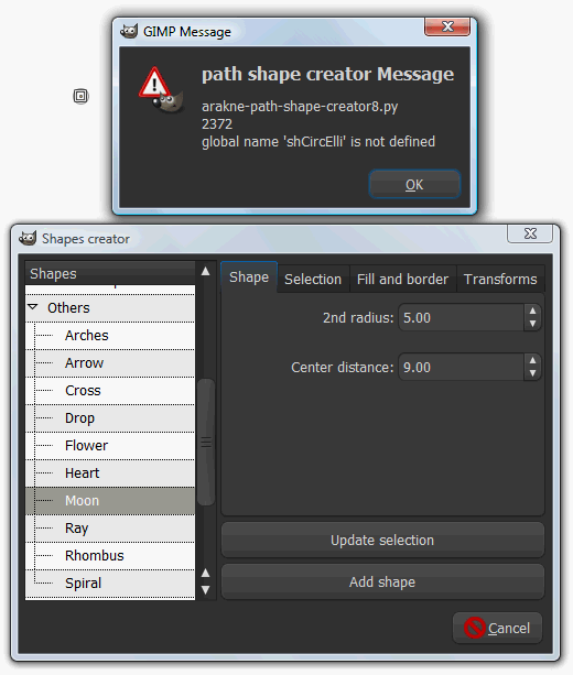

For me, the problem was Not solved until today...
I have always liked this plugin very much and used it very often. Since the change of Pythom MSC to GCC unfortunately for me it stopped working.
And today I found Noone and Pat625 message that it works.
https://gimplearn.net/posting.php?mode=quote&f=9&p=25389
I get only one error for Others/Moon - I can not fix it - just disable this shape - coment line 1521-1561.
For those for whom it also stopped working, they can try the attachment (many separate files have been merged into one).
Thank you very much, Noone - whoever you are :clap
