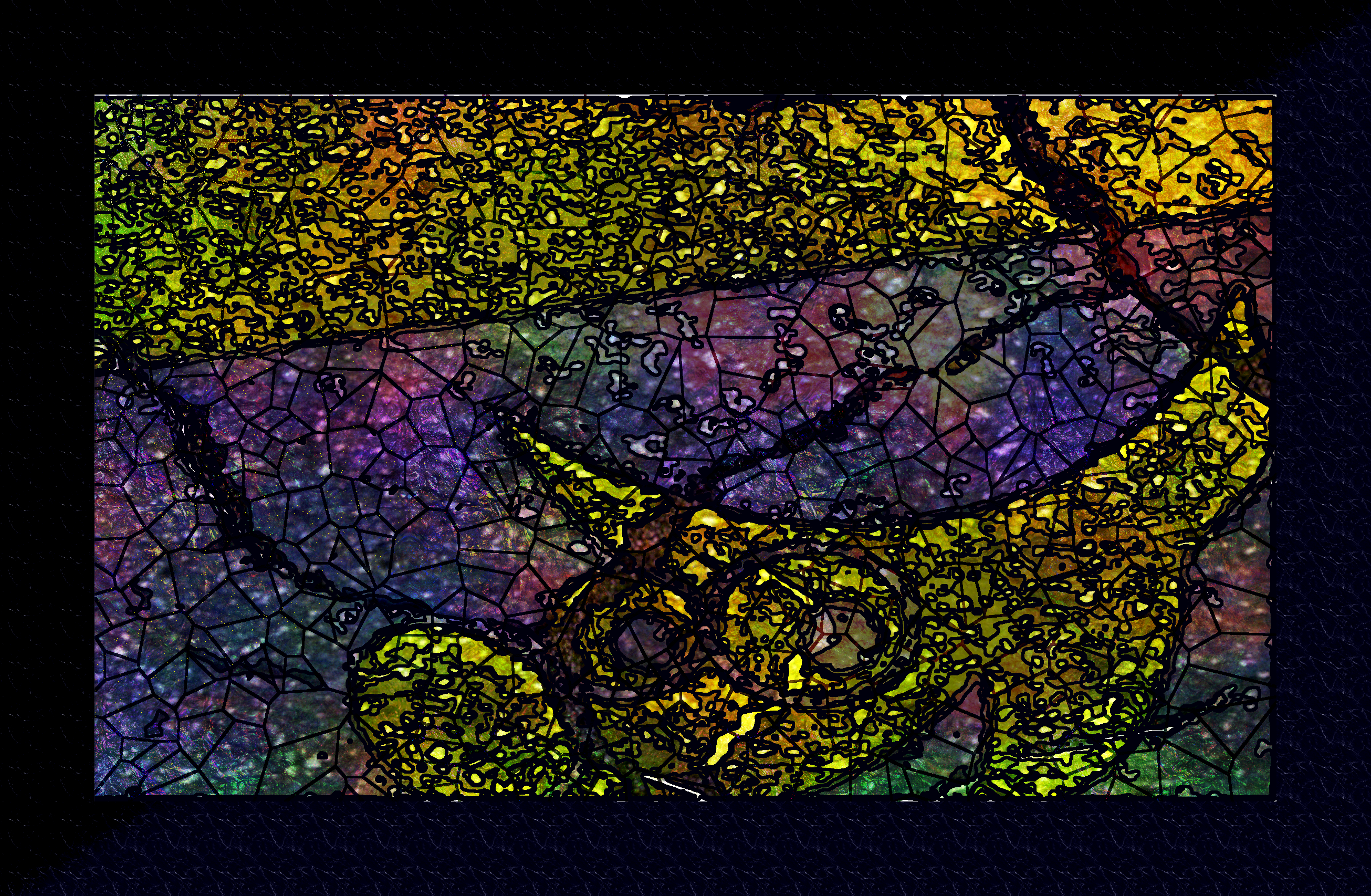

OK, it works now thanks.

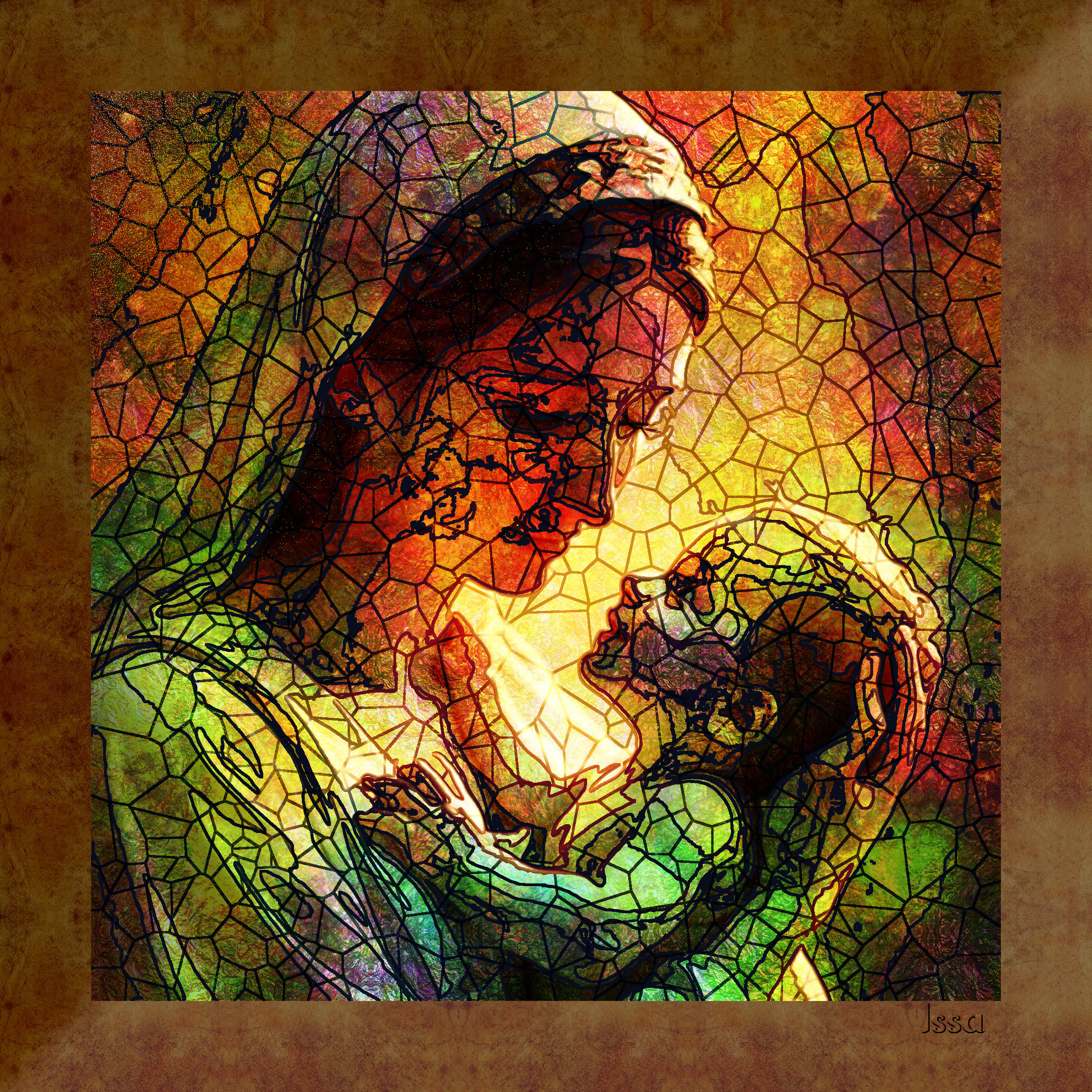

Posts: 14037
I am ppy to see you Dinasset acting in the forum. :hi5
I did a try with this wonderful filter. :paint
Thanks Dinasset.
