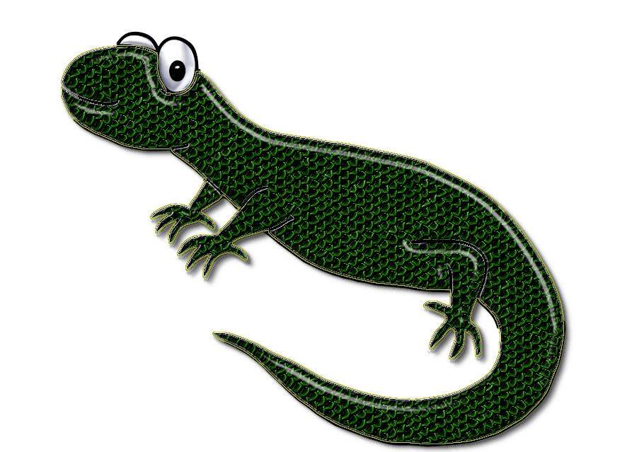

As suggested by Krikor, I upgraded to Gimp-2.10 (with a little extra: text box, direction, justification, letter spacing, line spacing, border, text edge color, text edge thickness, color inside text, displacement type, alpha to Logo with option: Active layer for new image).
Requires LayerFX.py + blur-gauss.exe [with Gimp-2.8_64bit] which are included in the attachment).
Edit: add option to keep layers
Lizard-Breath-V-3 + LayerFX + blur-gauss.zip [64.86 KiB]
Downloaded 344 times

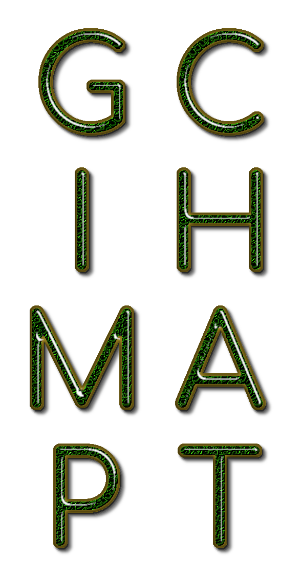

Leaving the layers was a great decision, and making the Alpha-logo version available was the icing on the cake, the script was perfect.
Running lightly and smoothly on my Gimp 2.10.21 win10
Thank you very much Rod, Graechan and MareroQ!

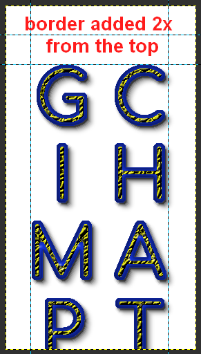

@ Graechan.
Thanks for pointing out - but this elegant solution unfortunately does not work for vertical text (a bug for the x, y coordinate) about what I mentioned here:
viewtopic.php?f=9&t=9290&start=30#p255704
Now there is also a problem for border.
