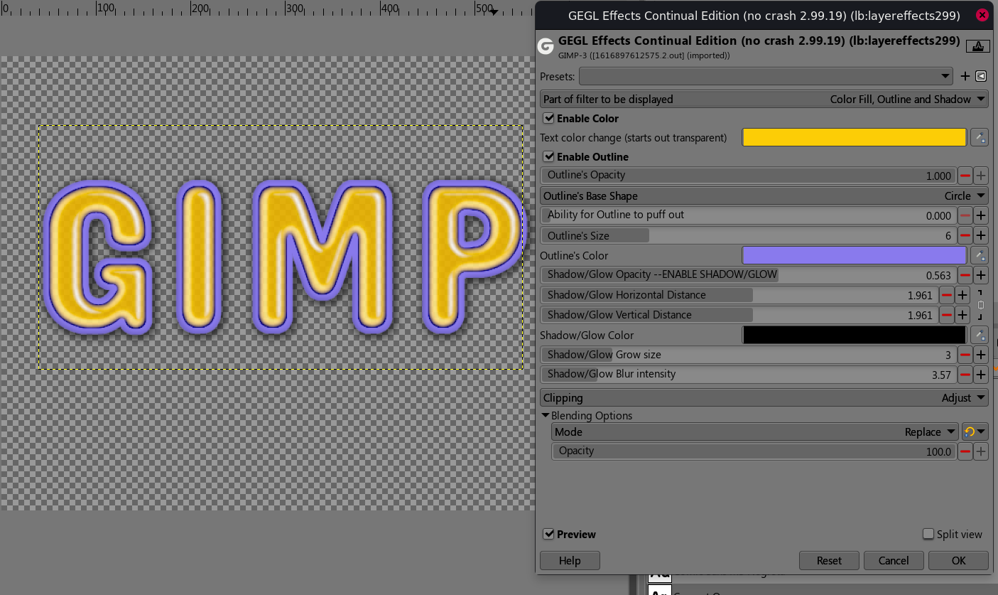

Source code + Windows and Linux binaries of a new build of GEGL Effects that lacks gegl:crop - hopefully this means no crash in GIMP 2.99.19. This build can co-exist with normal GEGL Effects but lacks three features listed above. They had to be removed because they use gegl:crop
The only new binaries and .c file code are gegleffects299 and inner-glow299 because this is their cropless counterpart. All the other binaries are the same as the latest GEGL effects on Github. Because this version of GEGL Effects is very different all presets broke
Download to 2.99.19 compatible GEGL Effects (which can co-exist with default)

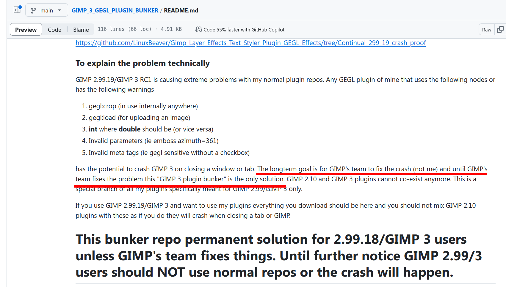

https://github.com/LinuxBeaver/GIMP_3_G ... GIN_BUNKER

The fix is here (60 GEGL plugins that don't crash GIMP 2.99.19 on close, but features were removed)
https://github.com/LinuxBeaver/GIMP_3_G ... /releases/
If you use GIMP 2.10 completely ignore this. If you use GIMP 2.99.19 and don't care for GIMP 2.10 do the following.
Remove all binaries from
#Windows
C:\Users\(USERNAME)\AppData\Local\gegl-0.4\plug-ins
#Linux
/home/(USERNAME)/.local/share/gegl-0.4/plug-ins
/home/(USERNAME)/.var/app/org.gimp.GIMP/data/gegl-0.4/plug-ins
They should be nothing in the folder. Then put binaries above from the zips (or self compiled) in the folder for your respected OS. Then after you restart GIMP 2.99.19/GIMP 3 you will see my plugins in filters>text styling filters>render>fun and other places.

The ultimate goal is for GIMP's team to fix this problem not me because people who don't update my plugins will experience the crash without knowing why.
once it is fixed this special repo will be archived and users will be recommended to go back to the normal plug-ins

https://github.com/LinuxBeaver/Glass_Tiles_Gimp_Plugin/
I tried really hard to make compatible with 2.99.19 but it won't work without gegl:crop - without crop gegl:grid has problems

I am devastated to post this.
https://github.com/LinuxBeaver/Gimp_Mar ... n/releases
My marble plugin is broke in GIMP 3. :( - it can't function because it uses gegl:cell-noise - a render filter
GIMP 3 is destroying my plugins. GIMP devs seem apathetic and don't understand I put 1000s of hours making these plugins only for GIMP 3 to destroy them.
