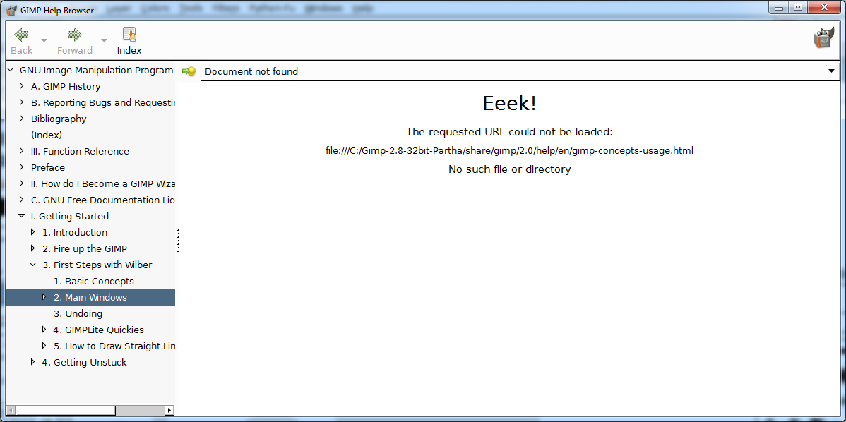

Rod all is fine on 2.8 32bit except for this error
this happens when I select this

Okay here is how i fixed it. (sort of)
1) create a new html file named
gimp-concepts-usage.html
2) copy everything in gimp-first-steps.html to that new html file.
place the new file in the share\gimp\2.0\help\en folder and test it.
You will need to scroll down a bit for the basic concepts info.
The problem is when basic concepts is supposed to load it needs the html# reference for the information on that page. I imagine the same goes for paths and using dialog windows.
You will have to just remember to scroll down the page that the help browser loads to find the information you need.
When Gimp is compiled it creates these menu items so the c file for the help-browser would need to be changed to reflect the difference i think.

As you saw before the plugin (when selecting "Basic Concepts" ), would not load the html page because it didn't exist.
So creating the "gimp-concepts-usage.html" page and copying all the data (view src) from gimp-first-steps.html page to it creates the content you need.The plugin will then call the page you created and show it in the help browser window.
