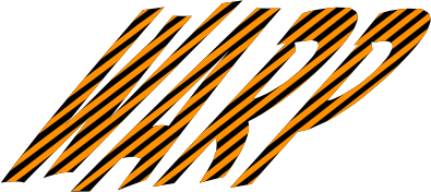

I have made a few minor changes to the script and have updated the file (still at the same location). You should replace the original file with this substitute.
  • Named the warped path based on the name of the original envelope path so that it will be easier to keep track of multiple separate shapes (as Oregonian demonstrated).
  • Script should work on grayscale and Indexed images now.
  • There is now no need to have a layer active to run the script. When using an "alternate path", a text layer is not needed and the script can now be run if a channel is the active drawable (previously the menu command was grayed out). Of course, if you don't check the "Use alternate path" box and the active drawable is not a text layer, you will receive an error.
There is a problem that I need to solve before I can implement additional curve points: when points are added between the last anchor of a path and the first, the added point sometimes becomes the new first point. :gaah I will likely post more on this later and seek advice, but that enhancement is on the back burner for a while.
If Rod doesn't mind, I will use his idea of the yellow stripes to describe how the "Use alternate path" option might sometimes be used for creating warped fill patterns.
After warping the text to its envelope, create a new layer and fill the warped region with black. Then...
  1. Do an "Alpha to selection" on the original text layer.
  2. With the Rectangle Select Tool, click on the selection (you should see the resize box appear with handles in the four corners). Then move the mouse pointer to the top center of the selection so that the center resize handle appears (do not press the mouse button). With the mouse pointer hovering over the top center resize handle, hit the left cursor button on your keyboard (the marching ants should switch to marching around the rectangle, instead of the text) and then click the mouse inside the selection or hit the ENTER key to accept the selection. (This step effectively converts a selection to its bounding box.)
  3. Save your selection to a channel (for later use).
  4. Perform a "Select->All".
  5. Activate the Quickmask (the Select All means that you will be rendering on a white channel).
  6. Use "Filters->Render->Patterns->Grid" to create horizontal black lines (you need to unlink the Width spinners, set the Vertical width to "0", and set the Horizontal width to one-half the Spacing value).
  7. Use the Rotate Tool to rotate the grid diagonally ("-45" degrees).
  8. Exit Quickmask. You should now have a selection of diagonal strips covering most of your image (but not the corners owing to rotation).
  9. Activate the rectangle selection channel you saved earlier (it should already be active, but make sure if it isn't).
  10. Hold down the CTRL+SHIFT keys and click on the red square "Channel to Selection" button at the bottom of the Channels Dialog. (Your selection should now be the intersection of the diagonals within the previously defined rectangle.)
  11. Perform a "Select->To path". This is the "alternate path" which you will be warping.
  12. Go to the Paths Dialog and activate your original envelope path.
  13. Run the Warp Text script, specifying that an alternate path should be used and choosing the saved selection from the dropdown.
  14. After the script has finished, click on the red square "Path to Selection" button on the bottom of the Paths Dialog.
  15. Activate the warped text path, hold down the CTRL+SHIFT keys, and click on that same "Path to Selection" button.
This selection can now be used to fill the warped black layer with warped yellow stripes.
File comment: Final result

Man, I didn't think I could do all that but I did! I'm not very familiar with channels but I sure didn't want to add another path to the mix so went ahead on the channel.
I think my envelope could have used some curves but it's too late for this image. I think I goofed up on the stripes. They were still in the shape of the envelope instead of the warped text so I filled the orange stripes on a separate layer, did alpha to selection on the warped text, inverted and deleted on the stripes layer.
That's a really cool way to warp the stripes, saulgoode! Kudos! Brilliant use of the Quickmask.
Question: What does Ctrl + Shift + Path/Channel to selection do differently from just clicking on the to selection button in those?

Ah! Thanks for that explanation. Now I understand where I went wrong on the first one. I think I did not do c + s + to selection. This one was done correctly.
