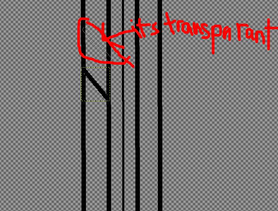

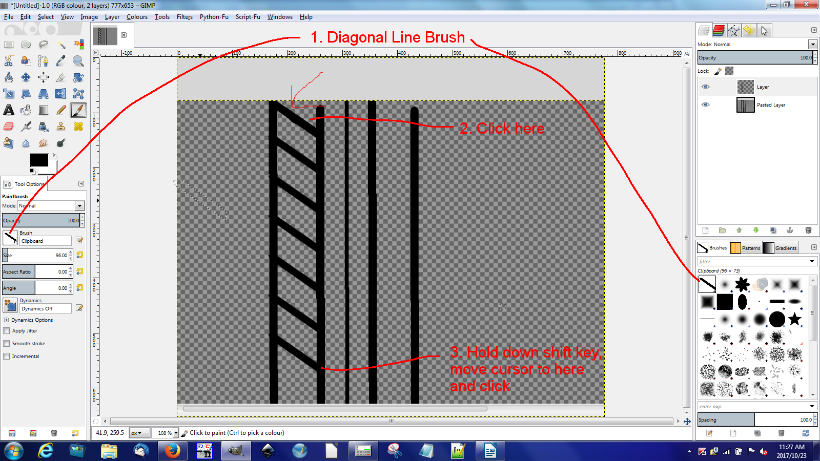

Still not working. My copied diagonal line is transparent. I dont know if its meant to be?
Here is two pictures one of the transparent copied diagonal line the other of my brush settings.
The brush is "transparent" just to show the outline so that you can see where the line will be painted. Once you click the line is painted with the foreground colour (currently black).

Lisa, are you trying to paint where there is no layer because you cropped it to make the brush? Try either making a new layer before painting or after you have made the brush, right click the layer in the layers tab and choose "layer to image size" to restore the full layer. Then try painting.
 Post subject: Re: dupuclating diagonale lines in a drawing
PostPosted: Mon Oct 23, 2017 5:45 am  (#11)
Joined: Sep 23, 2016
Posts: 317
Yes, I think Erisian is right. You have the layer of the diagonal line selected - a small layer. Make a new transparent layer (full size) and paint on that.

Thank u so much. I had to redo the whole thing. I somehow made a mistake with the coping ( i think or maybe the layer) but its working now. I just have to work out what went wrong for next time.
