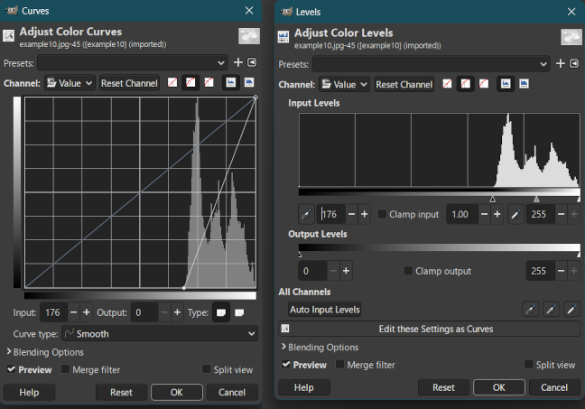

What if we were to use the Brightness Contrast tool, we get the same thing as the Equalize tool, with some differences, making it still off in the grayscale. Even if you try to use the Exposure tool, it will fail there too, which is another impossible task, because it needs the same thing, color values. Now if you don’t want to go the blending mode route, your second-best choice is the curves tool, or the other good options is the levels tool. Which require you to adjust the pixels levels by stretching your active layer histogram without boosting the contrast or leaving a haze in the image.
Your probability thinking, why learn how to do this when you have all these advance tool?
It is the basic of imaging correction, and can be the different in saving time and creating a
keeper to be proud of or letting it go. Part 3 has good examples of this being used.
