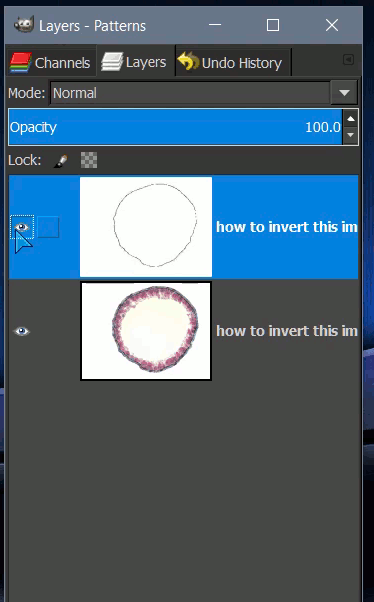

I am trying to perform an image analysis. I made the stroke selection and selected the required area. After this I made invert selection of the region outside the selection. But I am clueless of how I remove the inner region (area inside the stroke selection).

I first duplicated the layer and ran,
Color> Desaturate> Louminosicty.
The I applied a Color Curve.
Using the Fuzzy Select Tool.
I selected the inner portion of this image.
Then switched back to the bottom layer,
with the selection still active and cleared the pixels from the inner portion of the image.

Thanks Wallace. I tried to do the steps that you did, but was not able to do the last step (switching back to the bottom layer, with the selection still active and cleared the pixels from the inner portion of the image).
I am sorry I am pretty new to image editing and just know a thing or two. How do I switch back to the layer and clear the pixels.
Regards,
Highlander
Turn the visibility of the top layer off.
By left-clicking on the tiny eye to the left of it's layer.
This will make the bottom layer visible in the larger main canvas.
Make the bottom layer the active visible layer.
By left-clicking on this layer,
within the layers dialog.
With the bottom layer now the active visible layer.
You can clear the inner portion of this layer.
Using the selection that was made from the top layer.
