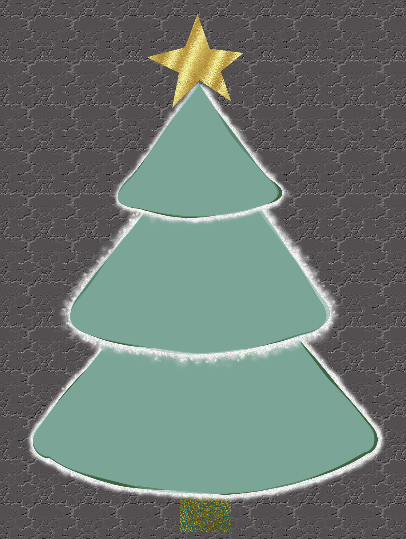

Thanks a lot Skinnyhouse. I did a first try, but I must practice it much more. :hehe
Wobble-Variation-try 1.7z [2.91 MiB]
Downloaded 76 times
