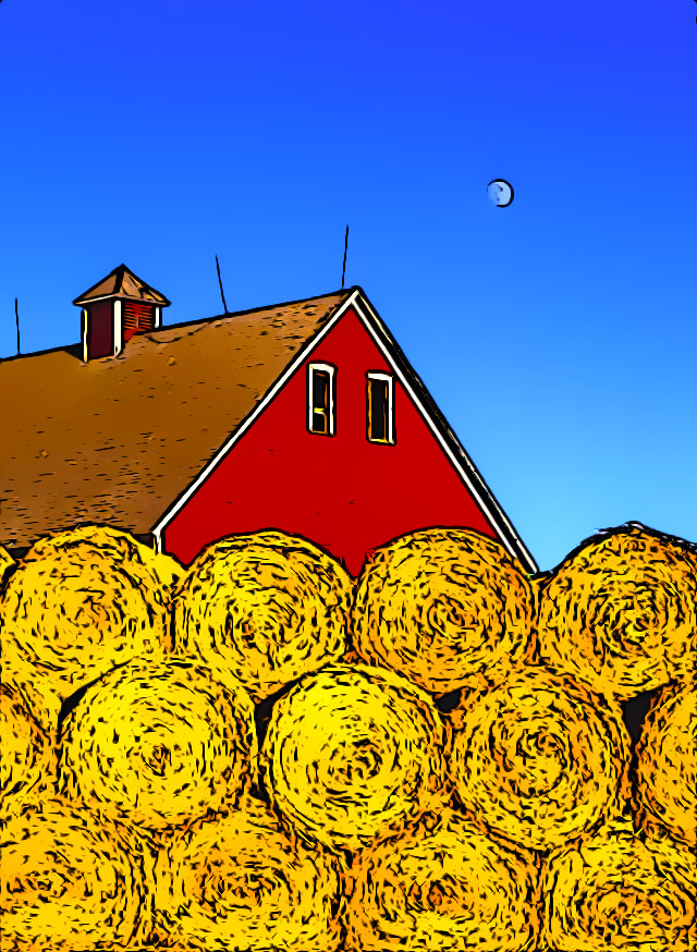

Here is a better example (photo to cartoon):
id=myStart
noise-reduction
domain-transform n-iterations=5
difference-of-gaussians radius1=1 radius2=0.33
gimp:desaturate mode=value
levels in-low=0.007 in-high=0.009
invert-gamma
rgb-clip
multiply aux=[ ref=myStart saturation scale=1.8 hue-chroma lightness=10 ]
noise-reduction
Here is a result of this example:
Enjoy! :)
