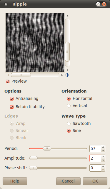

4. Go to Filters - Distorts - Ripples and apply the following settings:

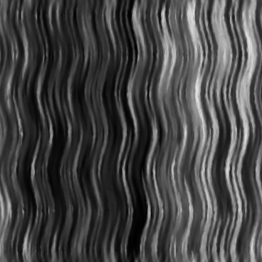

I went the coarse route, so my fibers look like this, at this point:

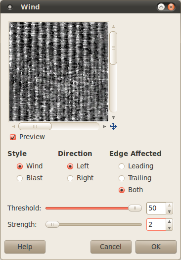

7. The next step involves Filters - Distorts - Wind at the following settings twice (once for each direction):

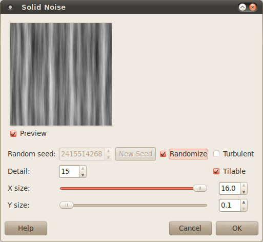

Open an image and run solid noise on it with these settings:
Then add a bit of ripple (not too much):
