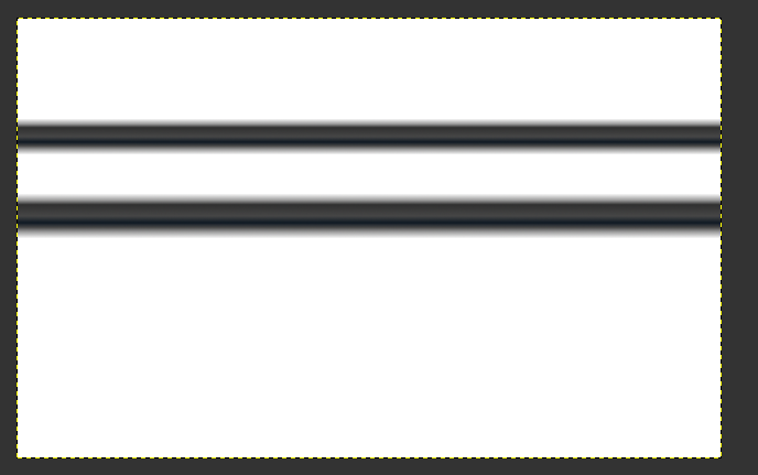

My metalic 8 stop gradient
Example Image:
