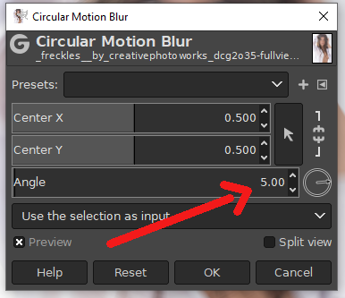

Pat, Issa, are you sure to look here?
Default is 5.00, I set 10.00 usually.
You are probably looking at X and Y.
