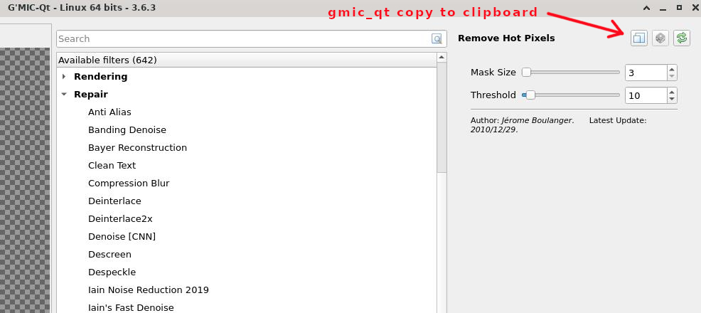

Gmic commands are now recorded from the top right hand side of the app. Clicking here will copy them to the virtual clipboard.
For example Remove hotpixels default command is:
remove_hotpixels 4,6
You insert that command into the batch file like this:

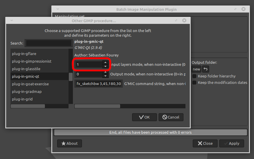

You can also do it within G'mic if you set input layers to "All" and you can set it to export new
image also if you want. This took less than a minute to make.
Bimp works well here, just make sure you set "Input Layer Mode" to 1.

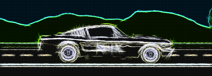

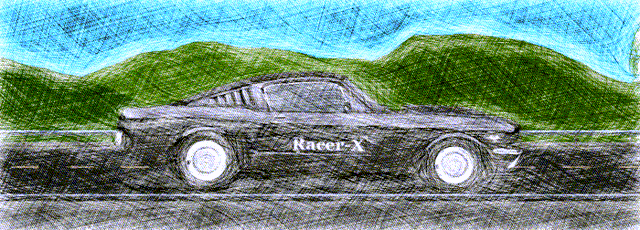

Here's one of my old animations converted using G'mic's "Sketch" filter. It was all done within G'mic and took just a few seconds.

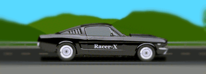

Here's my Mustang using G'mic's "Blur [Dept-of-Field]" filter applied.

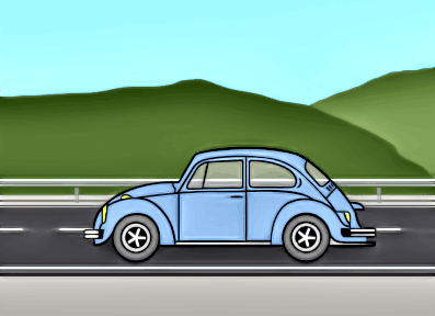

A first try with the old Beetle:

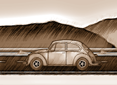

With illustrationlook or psyglass filters:
