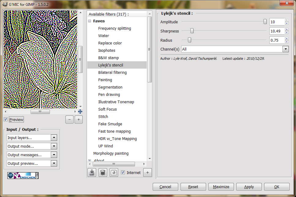

step one:

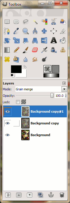

step three (note the layer property/blend in the animation:

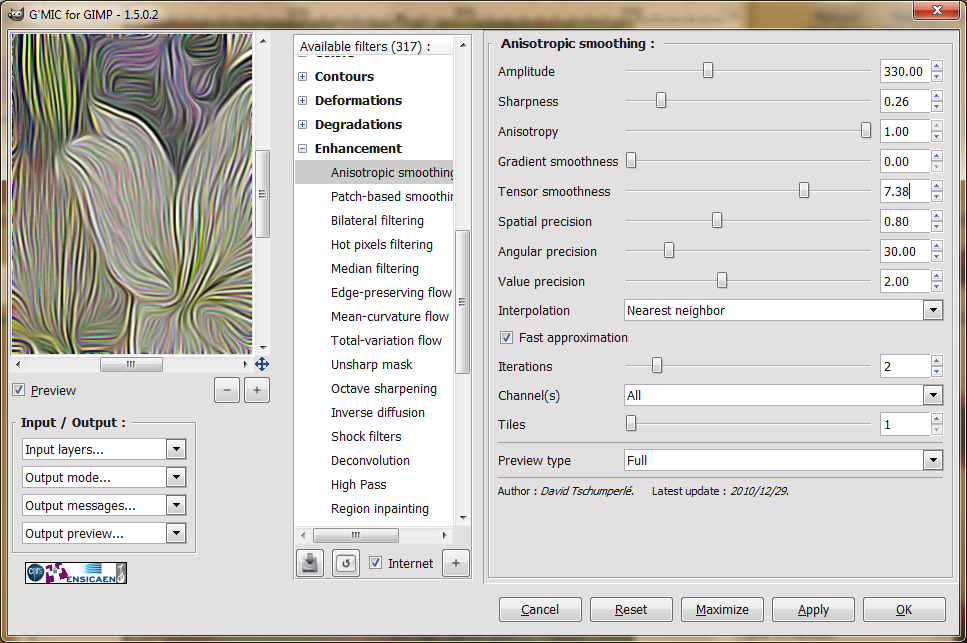

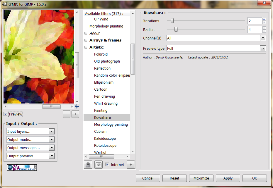

Step 4:

Hy Lyle,
I'm very interested by the whole process, and think I can write a simple G'MIC pipeline to make it automatic. Could you write a kind of tutorial with the descriptions of the exact steps you used ? Particularly, I'm not sure about the layer blending modes and opacity you use, and on which layer you apply the Kuwahara filter (is it on a flattened image) ?

Very cool, Lyle. I took the liberty of slowing down the layer animation image you posted. It was too fast for me to read the layer modes.

Hey David; the flow is as simple as outlined (the animation stunk; not sure why this site plays it so fast; lol). Like your result too. Thanks for all the replies as well. Very good result O. Man, I like G'MIC; so many ways to do things just inside it. The texture blending I didn't outline, but what I did was copy my flattened result after the Kuwahara step and used it as a mask for the texture that I applied (actually inverted it since I mainly wanted to get the darks the texture and not so much the lights. Also, with a copy of the same texture I set to darken and reduced the opacity way down to taste (wanted some texture on the lights too but no as much as I wanted to on the darks). My secret now revealed. lol

To David; some controls that would be cool to control are an option for texture or not, and, w.r.t. to the Kuwahara step, retain sliders for radius and repeat since some play here I found may be necessary for the end result. Still cool to have the whole process automated now. You know how much I like making the computer do all the work (since I'm lazy). lol
