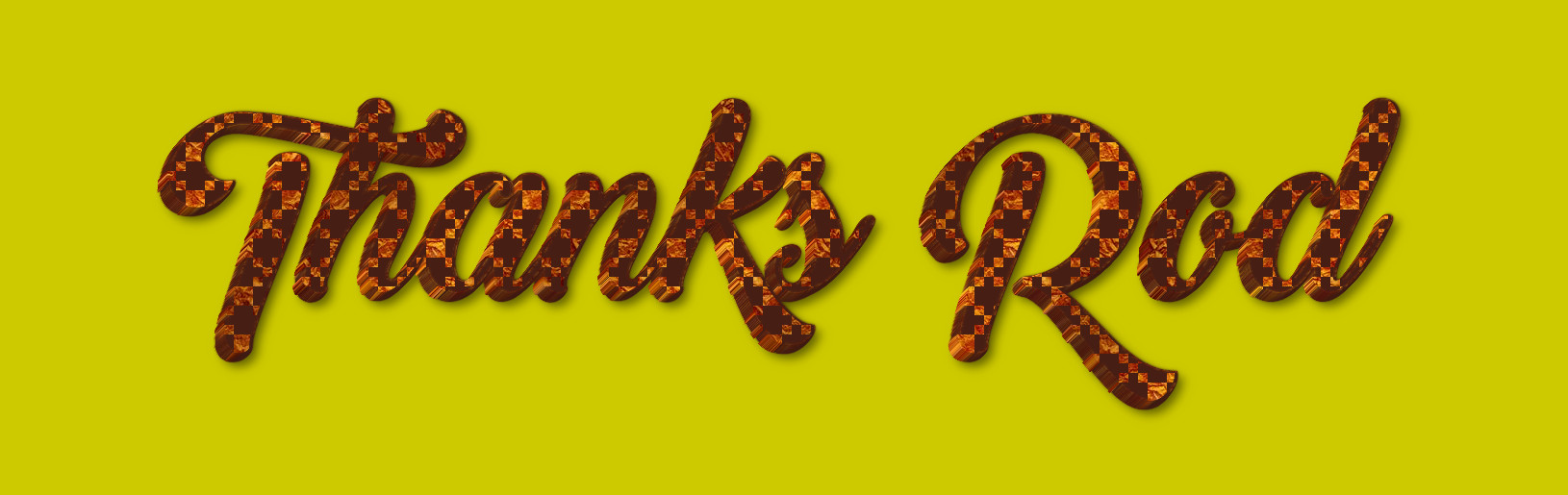

Posts: 14209
Thank you so much Rod. I got it perfectly and I'm sure I'll continue using your scripts. :coolthup :tyspin
