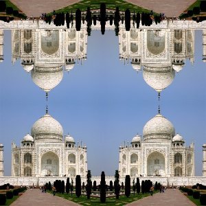

mahvin wrote:
I am finally getting somewhere with MathMap, using the composer with Droste and Mercator filters. I did have to jump into G'MIC to use mirror array, (is there anything similar in MathMap? - I didn't see it)
Not sure how mirror array works.
Here is a mod of the tile mm script to be a mirror tile:
stretched filter mirrortile (stretched image in, int n: 1-10 (3))
  if (floor(((x+1)*n)/W%2-1)) then
    newx = ((x+1)*n)%2-1;
  else
    newx = ((W-x+1)*n)%2-1;
  end;
  if (floor(((y+1)*n)/H%2-1)) then
    newy = ((y+1)*n)%2-1;
  else
    newy = ((H-y+1)*n)%2-1;
  end;
  in(xy:[newx,newy])
end
Hope that does what you want.
-Rob A>

The mathmap mirrortiles code works awesomely! Thank you!!
